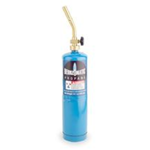

I s this somewhere you can take a propane torch to them. A couple heat cool cycles and your other methods should work.....

pick up a torch...works abosulte wonders on stuck exhaust components.............

Well I tried it without the torch this morning just to give it a go after using liquid wrench and the easy out snapped off. I put it back together with 2 gaskets on that side. Still a little loud. I will go down and get 2 more on Monday and see if that seals it up a little more. How long will it take before damage my new valves? I hope to replace this motor soon with a 27 hp kohler.

if you gonna heat it ...heat around the stud without heating the stud as that would cause the stud to expand........
