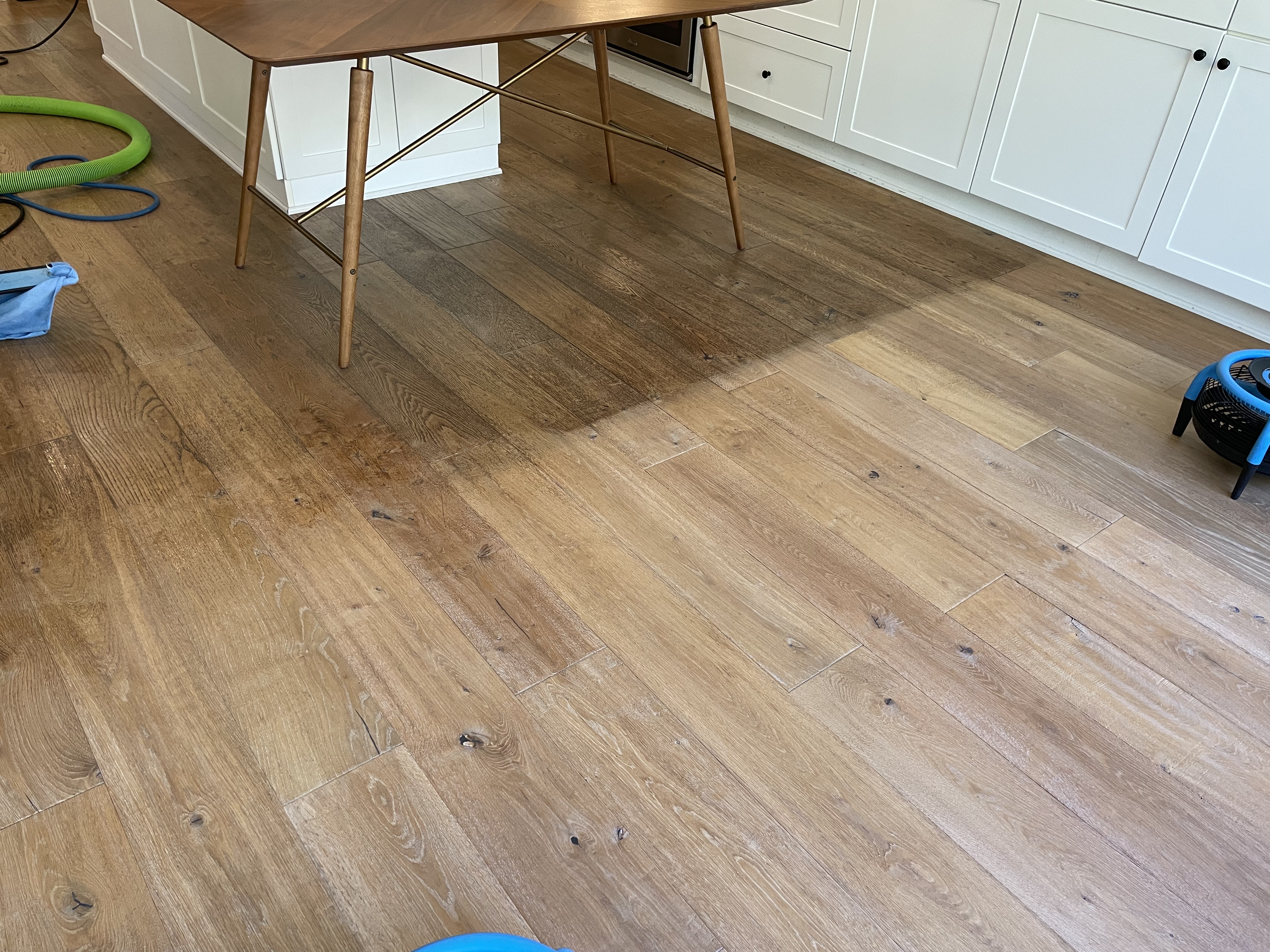

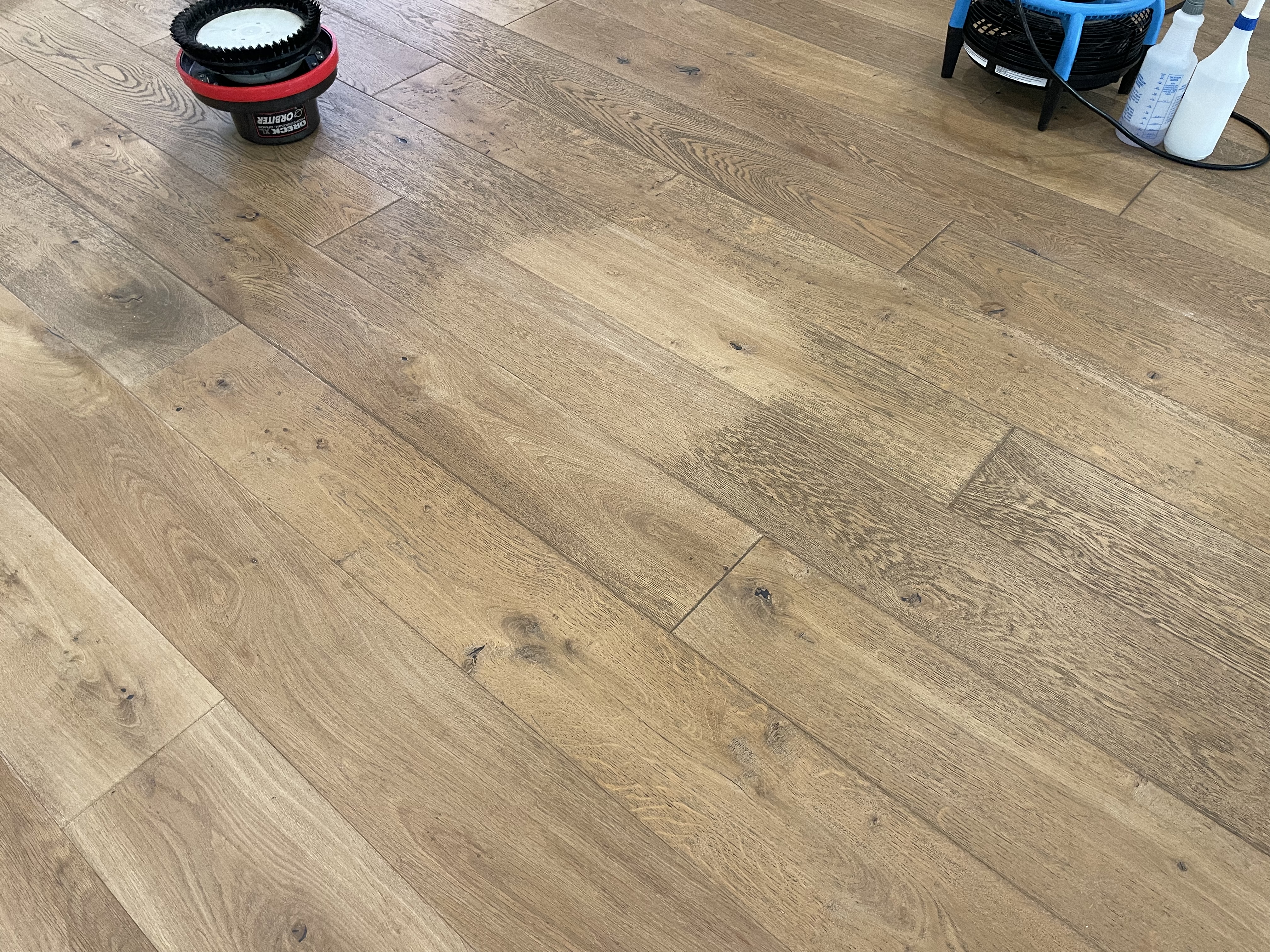

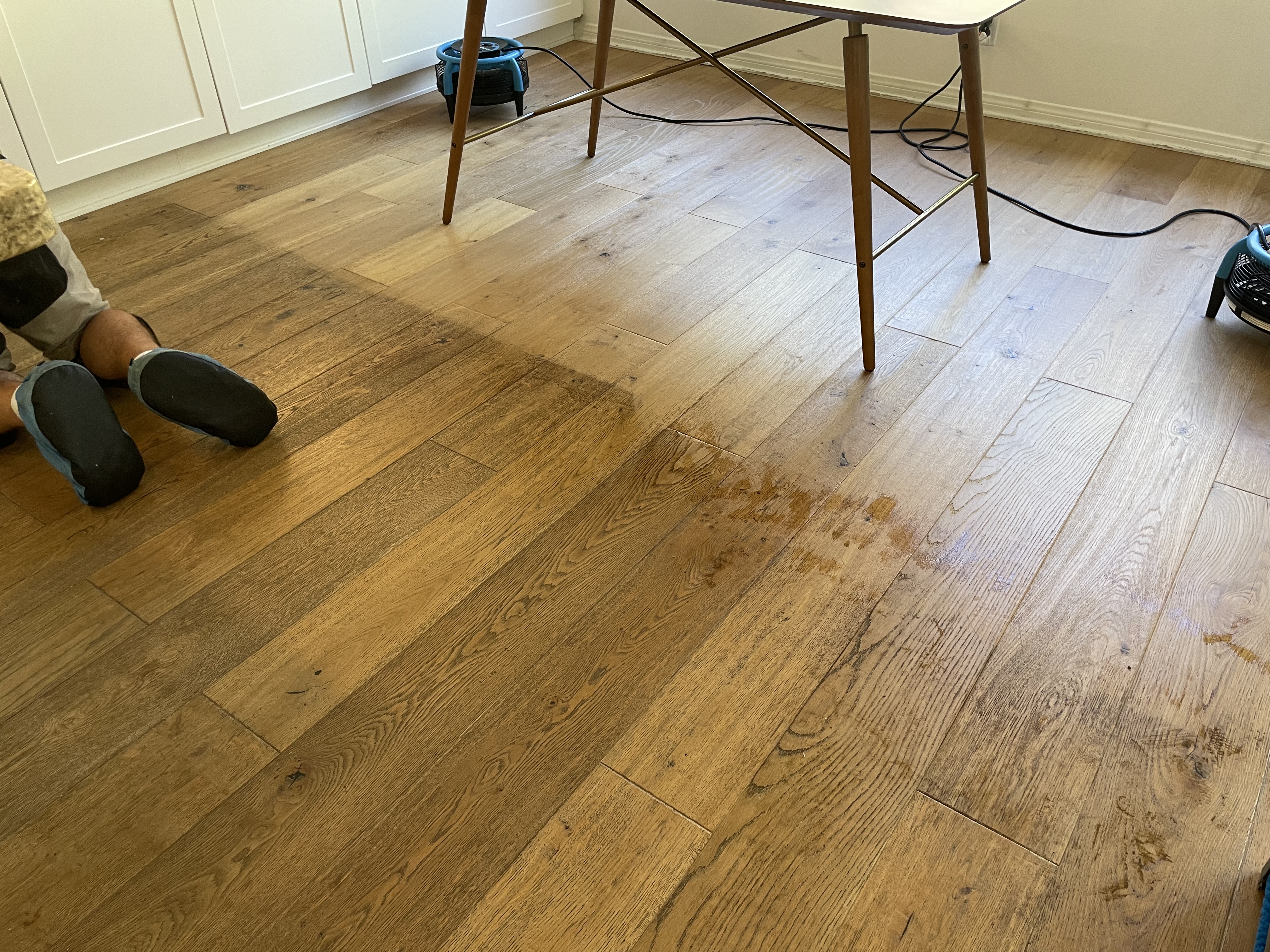

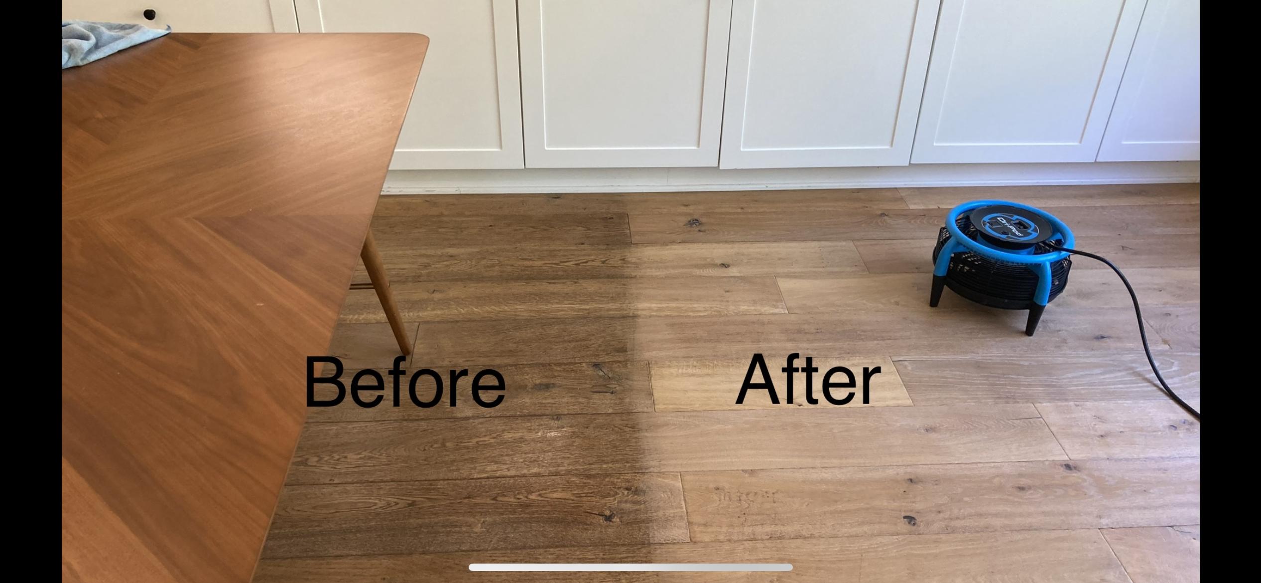

Demo spot with oreck orbiter black carpet brush and basic coatings dissolver, then rinse with squeaky and dri pod.
Vivers
Feb 20, 2012
833
Bill
Residential work I think your system is a lot more controllable and quicker than running a mini walk behind machine that doesn't get to the edges or under cabinetry and or around furniture.
Obviously I prefer a 12-in carpet wand with my brush light on it to rinse with.
Many if not most would and would look alike floors can be prepped with just a flat mop and a pole brush, and then rinsed with the wand with his little as a shower feed if you use your ball valve to control the pressure.
Brush Pro killed it!!
