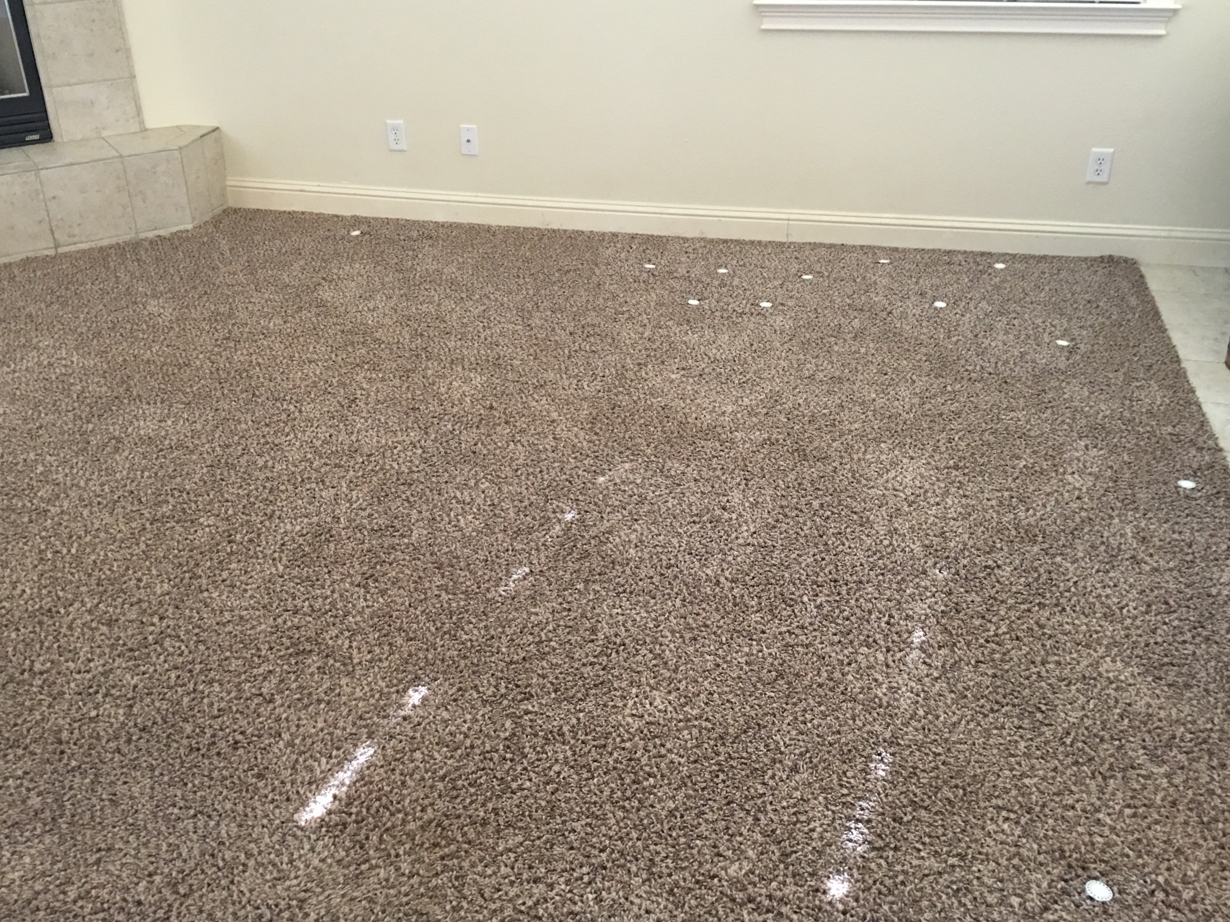

I show up to a job where the tenants are complaining about heavy urine odor from their dog. They tell me they already cleaned the carpet with a rug doctor. I click on the UV light and it’s pretty much useless because they had done a very nice job of smearing everything around evenly. After doing my best to identify the heavy areas I total up my costs and hand them the bill for $299. The woman started crying and the guy bellowed over and over he only had $200. Good grief.
I ended up removing 2 rooms of work from my already commercially priced estimate to meet their budget.

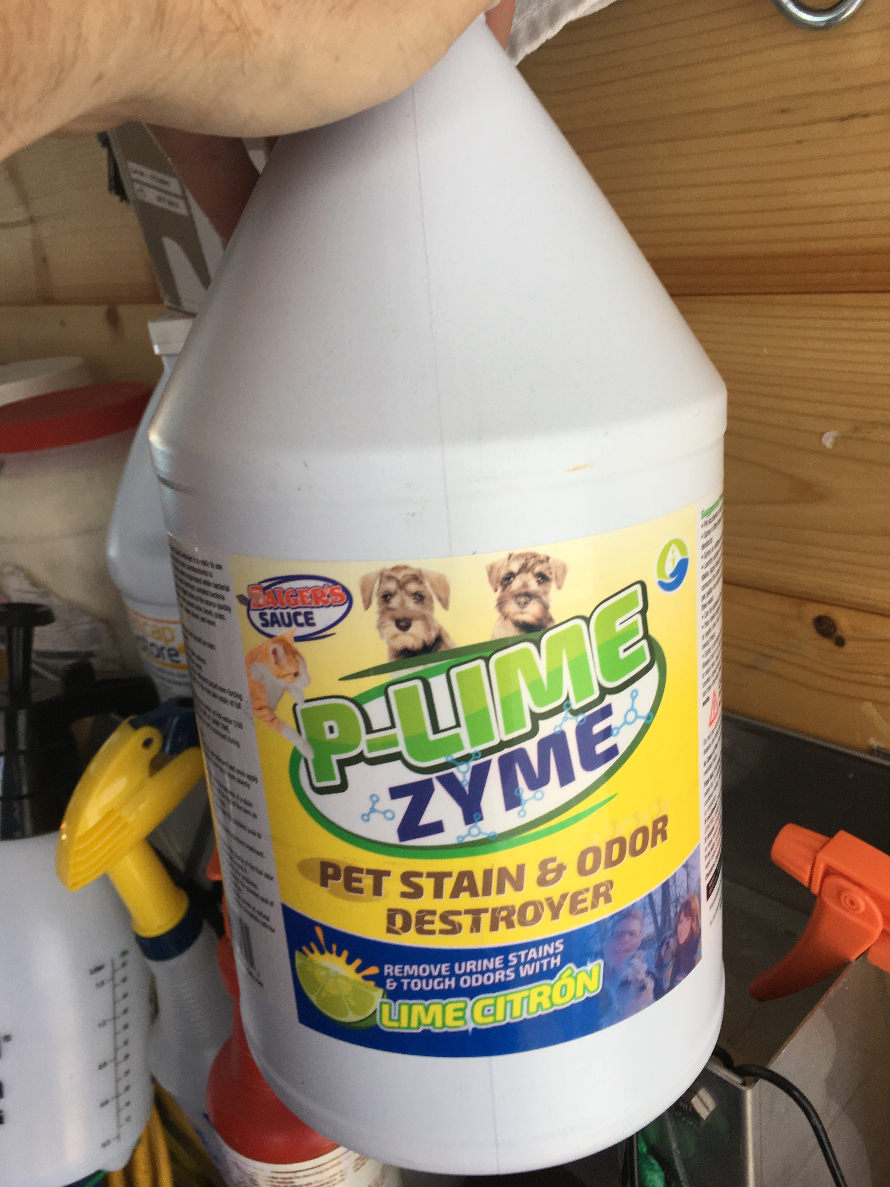

So what am I doing? Water clawing about three gallons of Saiger’s Pee Lime and then blanketed the entire carpet with it as well. I’ll then prespray with CitrusForce mixed with SaigerCide and acid rinse.
I told them I could not gaurentee my results since they had already smeared everything around with a Rug Doctor. It’s a glamorous life.

I’m with Jim on this one. But to save yourself a LOT of effort, use a watering can to sprinkle the PeeLimeZyme and then your 6” Geko tile wand to extract. It goes quicker and sucks just as hard as the waterclaw.
Then run the wand or rotary over it just for fun.
