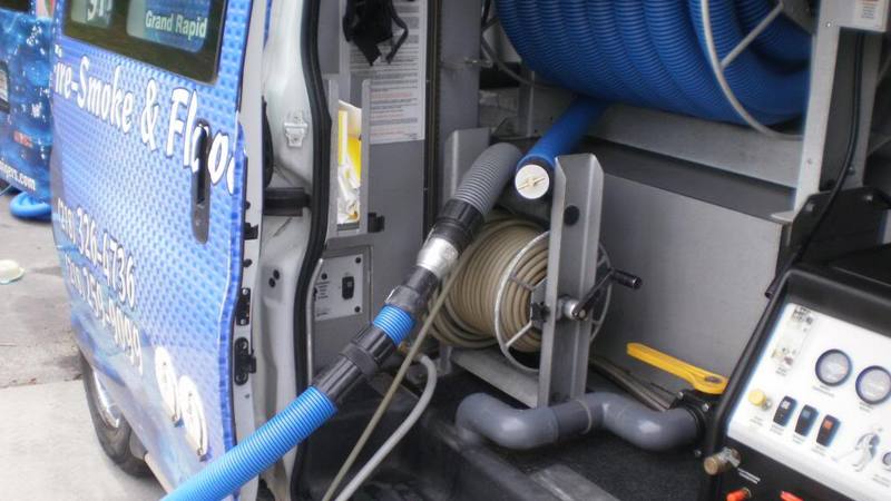

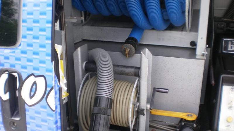

Butler 2.5 live hose reel set up options
11,200
And this is my first Youtube video....

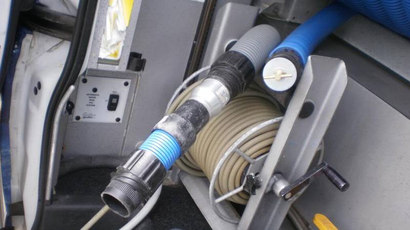

Just wanted to show people who have been asking how we set up our live reels (since we don't use a live reel stock).
Posted this also on my Facebook accounts in case the link doesn't work properly.
http://www.youtube.com/watch?v=Cg6LkkmYwsM
https://www.facebook.com/Saigers
Will try to post some stand alone pics of this set up too.
And Marty...here is that video I told you I would eventually get to. Hope it makes some sense now.

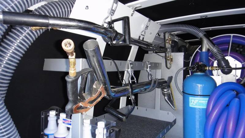

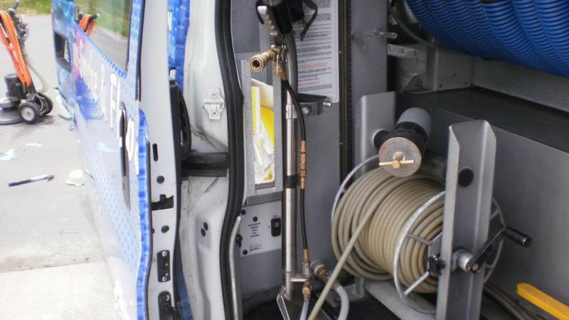

Looks good..
Where did u get those hooks holding your tools? Those are sick!!
11,200
Looks good..
Home Depot...they were part of the Rubbermaid track hanging system. Just had to add a bit of support you will see with a small homemade "L" bracket out of diamond plate to help support the top ones. The are working slick for us right now.

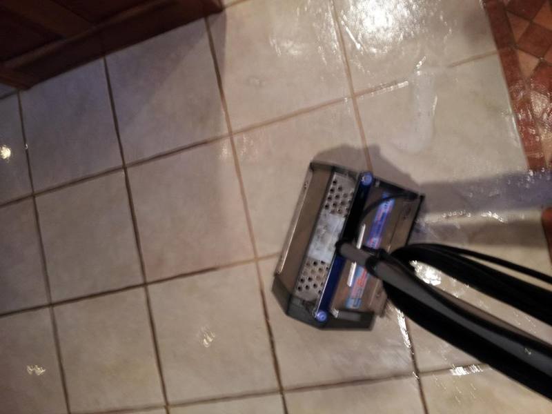

Do I see a spotter salesman kit .. how does that go for ya (assuming that is what I see)
Do you like your 4jet tile tool better than a SX12
49,923
It makes sense, now that I see it. Personally, I'd get tired of coiling up that 2 inch by hand on every job.
11,200

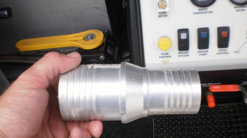

I set up one of my friends with less hose on the reel and he had his 50 foot section of 2 inch attached to the 2.5 inch and reeled off either one 25 foot section (so now he has 50 feet 2 inch and 25 feet of 2.5) or if he needed 100 feet, he just kept pulling more 2.5 in the 25 foot sections.
Just gave him more options. For us, I like to have as mush 2.5 on the truck and available to me for maximum air flow.
Hopefully the video can give some ideas for using the "Live reel" option and make a faster set up for each individual.
11,200
Yes it is a spotting salesman kit....but I don't ever use the kit, but I do sell a lot of the product. Don't even need the kit much since my clients have come to know I have the product and ask for it.
I do use Turboforce spinners for tile and grout, but the hard surface wand is for other general hard surface cleaning and edging out jobs where the spinner cannot get. I have a couple that I got from Steambrite. http://www.***************/clean-st...nless-valve-brush-internal-spray-p-10541.html
http://www.***************/samco-hard-surface-wand-p-4684.html
Actually got the storm version last time I think and like it better than the Samco....they both do the job though.

I had someone contact me that there didn't seem to be much suction in the video and that the Butlers sure a quiet.....Just so you know, the Butler was in idle when turned on so you could hear me easier.
I will try and do a video while on one of or jobs today to see and here more examples.
Thanks for looking and feel free to contact with other questions.

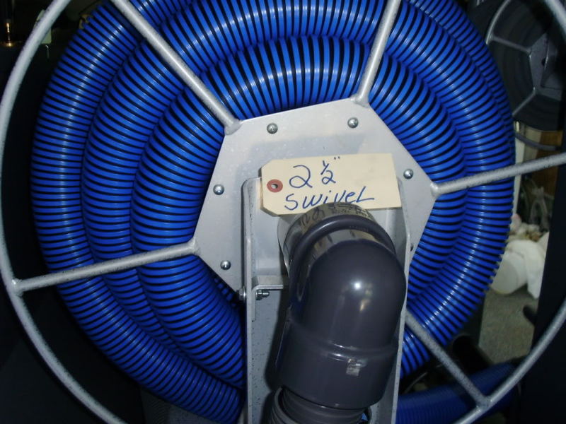

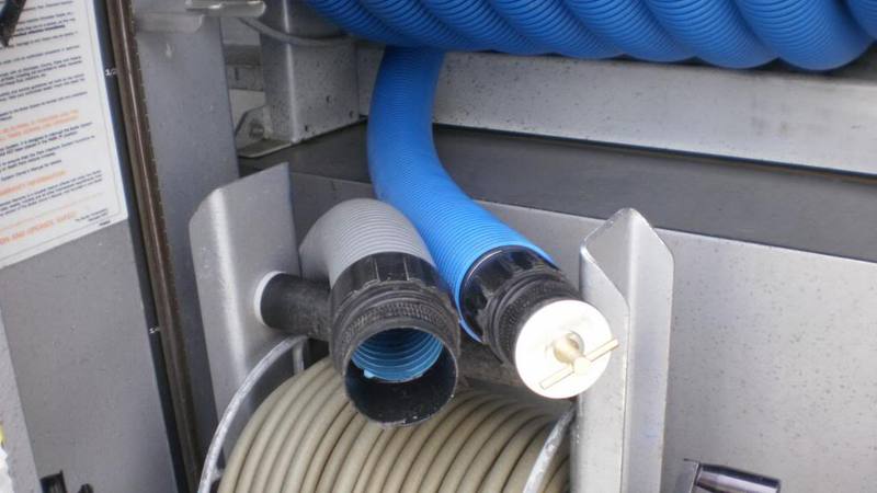

In the case where your pulling off all the 2.5" to use, why not just connect to the by-pass instead of the live reel? That 2.5" swivel is a restriction anyway. Why not forget the wye and just bypass the live reel altogether?
11,200
In the case where your pulling off all the 2.5" to use, why not just connect to the by-pass instead of the live reel? That 2.5" swivel is a restriction anyway. Why not forget the wye and just bypass the love reel altogether?
This reel is a true 2.5 inch and it is there...so we figured lets try and use it. Not enough restriction that we have found and removing it off the reel is just one more step to hook up. It is also more difficult to get that last section of 2.5 off the reel. We just found this was an easier way to use the feature of the live reel with the Butler and just keep trying to find ways to up our production rate and keep good air flow and cleaning quality.
I got tired of pulling and rigging and bypass this and that and came up with this for us to be quicker.
Just what we have found that works for us....and still get good cfm.

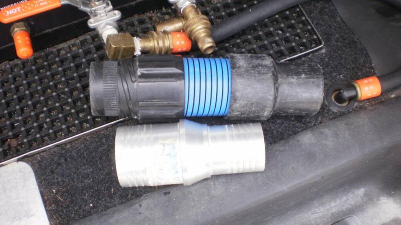

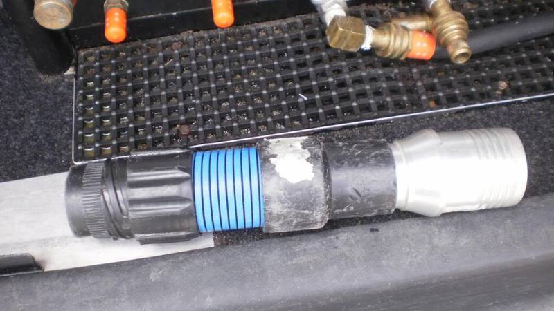

If I may make a easier suggestion.....it may work for you...it may not....
get something like this....(or even a piece of 2.5 inch hose that runs from your waste tank and down to the front of the vacuum reel would work also)...
put a 2.5 to 2 inch reducer on your hose and just hook it in...
and if you need any of the 2.5 hose just hook the reducer to the 2.5....
and then just hook the 2.5 to a type of connection...or the 2.5 hose whip....
you might find it a bit easier to set up....no more plugs to mess around with and a lot less restrictive...with out the "Y" or the elbow.......

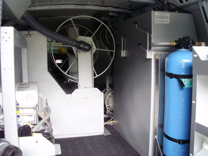

If I decide to go with butler on my next TM , I have some thoughts on how. I would like it arranged in back
Thinking about ditching their shelves , moving the filter box to the rear right and leaving the entire middle and left side open for tools chemicals fans etc
Reactions: hogjowl
11,200
Thanks for the ideas and videos. Mark
There are a lot of options a person can do. Butler will do things for you if you ask. I have found them to try their best to help. From their, I just personalize the units to how we like them too.

Pretty well thought out setup. I use an electric reel, and the first 100 feet is 2", the second 100 is 2.5, and then another 100 of 2". Would never be without an electric vac hose reel. I still hand roll the solution hose, since you gotta stretch it out anyways.

How much sooner do you think the carpets dry with your 2.5 to 2 setup vs butler's standard 2 with a 1.5 whip?

We use some Butler products yet and some Harvard products, and....well lets just say we have a lot of different combinations. If you send me your email in a PM I will send you out some combo formulas we use that work well around our area and soil types. Also, you can go to my website and send me an email from our "contact us" button at the top right. www.saigers.com
For the wands....I like the Butler system and its durability and longevity of the Butler system, but I am not a fan of their wands or the 1.5 inch whip (sorry Butler). We use the Prochem Titanium 6 jet wands with .02 jets and hybrid greenglides. Then of course we use 2 inch hose from the 2.5 to the wand. With this size jet, we are still keeping great heat (even in our cold weather times) and we are getting better rinsing and flushing out of the carpets....and quicker too.
Dry times with this combination can vary of course depending on environment and outside, but we just checked one that was a thick polyester in one area and then downstairs a thick nylon and they were dang close to completely dry with using a hydrosenser II except in just a couple areas. The homeowners actually had the humidity set very high in the home (like 60%....yes I did say 60%) because her husband was more comfortable in that environment. So to have things that dry in that environment was encouraging. We also encouraged them to consider dropping the humidity level in the home for the homes health. :)
Now with the 2.5 inch hose, we did find that it did require a bit more effort to clean with because it did produce more suction...we thought we were in pretty good "Cleaning shape" then when we started using 2.5 inch hose, we discovered another muscle group....again. We were at that time just running straight 2 inch hose. I really have never run the 1.5 inch whip and Butler wand much, but I do prefer the set up we have now.

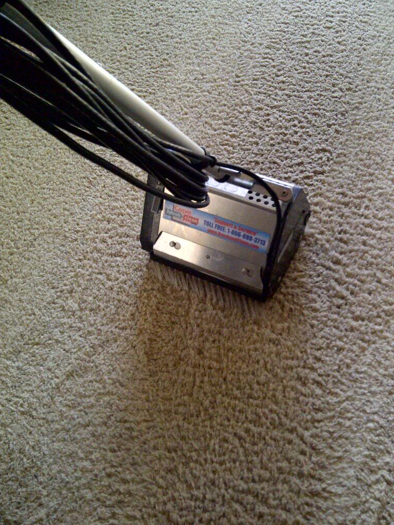

Hey Mark,
Thanks for all the great videos and information!
What kind of a CRB is that? Do you recommend it?
Steve
11,200
Hey Mark,
Steve
10 inch Brush and Clean. Came with the white brushes and we did not switch out to anything else. Seems to do the job and not seeing tip blooming with the softer white brushes, so we kept them as is.
We also like them on the steps and bullnose of steps. The machines have some weight to them and I went with the smaller units because my daughters were working for me at the time, and just were smaller for more room on the van.
We also use them on hard surface scrubbing. We have had them over 3 years now and not one problem with them. They get used everyday.
