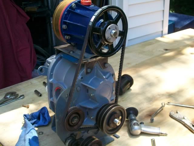

it's the belts slippin' Chris...that's all...prolly glazed!
I'm making up some belt tensioners that will help that problem....
no pics yet...but sometime this week.....if CRASH don pay for HIS...
it's going on the block!
OHH wait.here a pic

Whats your idea to stop the one on the engine from slipping when you get above 16hg?
the serpentine belt will NEVER slip if you have the right length belt..cuz it DOES have a tensioner on it as well...
