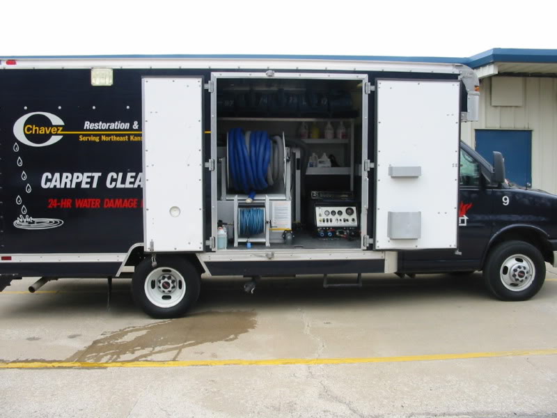

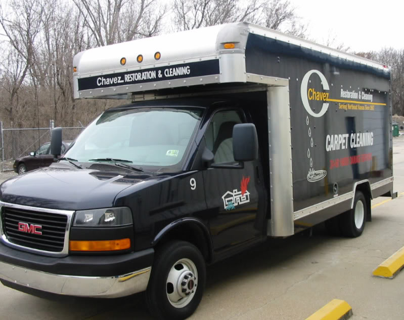

Here is ours.

Nice unit....ChAvEy.. :!:
can you please BE,,,"Doc Holliday"....this week.. :?:
It fits your character ...MUCH BETTER than...TOM... :wink:
