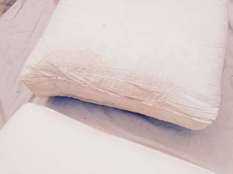

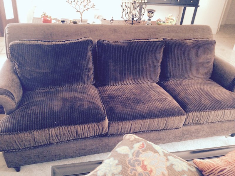

two sofas pissed all over by one cat. Not sure how one cat can put that much piss out. One cushion was Dacron filled but the other two were down. Urine reached all the way through into the feathers. I always using an immersion method for urine on the outside cases. Stripped off the outside and dunked them. Left each 5 minutes and then let sit in a lump. After finishing up the body's dunked again in a rinse then vacuumed dry and left in the sun. Treat and cleaned the inside three times to get rid of all the smell. It was harder this time than the last two times. Third time for these sofas. Took pictures but it won't upload for some reason

The cats actually have collars to keep them off the sofas but one of them the battery had died. Yes this the third time over a year. As far as cost I always charge for time and difficulty. This particular family has 2 cats and 3 dogs but no kids at home. Travis, I only submersion wash the fabric. I wouldn't try that with the down. I have done it with the Dacron filling on other jobs. Works really well. I use a 6 gallon bucket to soak them. It's always in the truck. 5 minutes seems to be enough time and then I let them sit. We do this outside because of the mess. Then I go back and rinse them out in a neutral or slightly acidic solution. It's much faster for such a bad problem. Been doing it this way a long time now. Just cleaning never seems to work on cat piss and submersion guarantees you get it all. Getting it out of the down took 3 times to pass the smell test and never is easy. I've had to cut the bag and remove some before but always get permission. Still won't let me upload

Chet I removed it from one foam cushion years ago. Never again. Just two slow to dry out the foam. They can get that part easily replaced from a local shop I only clean the outside in that case.
Troy I wondered about that. I've never had one to experiment on yet. If its Dacron or poly fill I dunk away.

Nothing is going to be more effective than immersion cleaning, And it's very fast to do. I only immerse the pillows that got hit. i hit the bags heavy especially since 2 were feathers. Dwell time was going on during other cleaning. It probably added 30 minutes in total time with 2 people working. It added way more to my bill. Basically I'm just charging for my time and I'd rather spend it in as few places as possible. She never asked how much and yesterday left a blank check. She wants it done , done now and no smell. Personally the couch isn't that great but everything was picked by a decorator and it all matches the room. These kind of people don't shop ready made and usually pay a decorator. I'm the easiest alternative. I wish I took pictures of the two Chairs she had us clean. The fabric arms on both were chewed off. She still wanted them clean until replacements come in.
As far as when do I draw the line I don't. That's the customers job.
