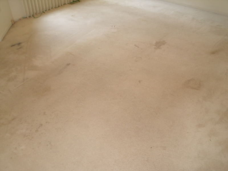

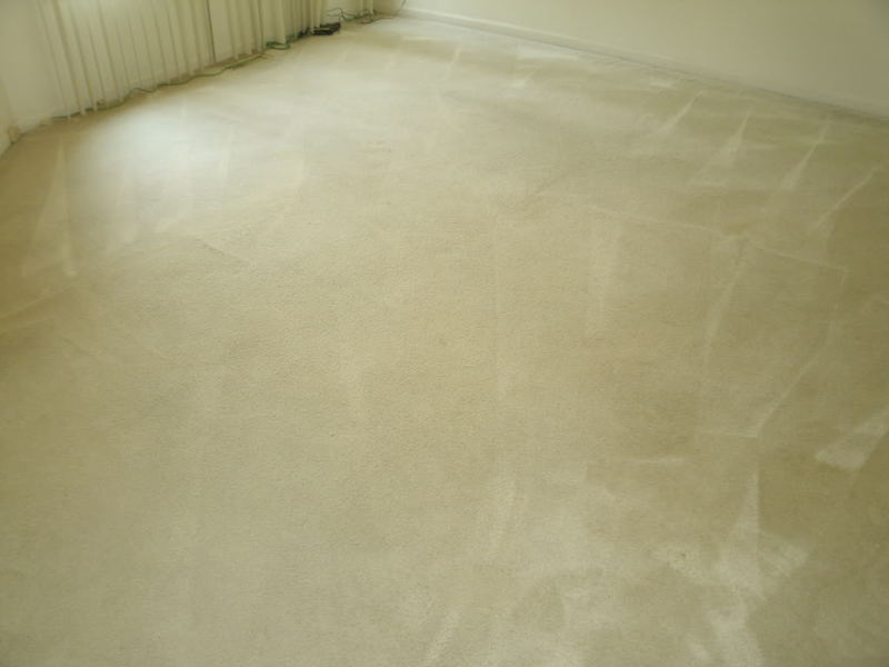

So I bought some Attack to test against my usual Grease Eraser. Test room today was a messy old lady room, she's been moved to assisted living.
Attack on left, Grease Eraser sprayed on right:
Didn't notice any difference. Attack smells nice while spraying , GE as no odor.
