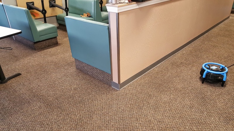

Last week when my pump was acting up I had a restaurant job that I HWE'd 4 months ago.
They have another location that I have been rotating HWE and Cimexing with great results so I figured I'd Cimex it this time and not risk having the pump die on me. I was worried that in four months this older carpet in their busier location might be too far gone for VLM and I was right.
I thought off all the VLM only guys who would have no choice and in their spirit I jumped in .My 175 and loads of pads was set up and ready to mop up the slop every 100 feet or so.. The Cimex being the Cimex bust all the soil loose in 3 to 4 passes and post padding was like running a wand over it. I've never seen such a dramatic difference with the second step like this. The pads were extremely soiled and juicy. I used both sides and almost ran out.
To be honest, if I had a helper and a solid pump, I would have ran the 360iBH..
So here are some thought I had while grinding away..
Why do cold Encaps loosen soil better than hot solvent based pre sprays?

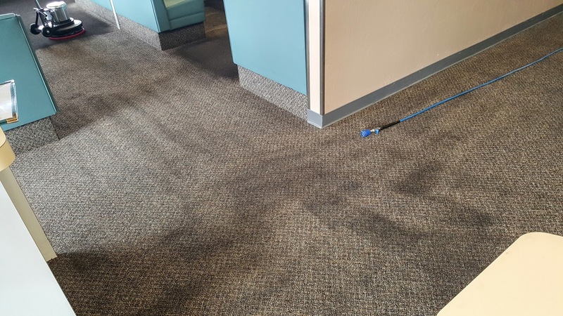

The first time I cleaned for these owners I applied a the highest pH prespray I had, loaded with solvent and oxy boosters, scrubbed with a new Red pad/175 and then Zippered and it came out like hell ..
B6W19-oInW-ZlbbVJJ_wabg8NX1Od2pwHf3ajcW9Uqja5BiwyyakpgW99w3nJWd5zGC6xv6a74Jhwpcq8Q=w1689-h950-no.jpg
I had to then respray and use the 360BH to get it right
8b_360BJI3kJv6fsOrFS090iO42cB3vA2UGxO4aRGCvcY-dc4yNvNCRUybP4fPvtLnDTaIuZMQ0ZUskHkg=w1690-h950-no.jpg
Which was really SLOW..
The BH is no fun to run on Glue Downs and you're luck if the valleys in the concrete subfloor allow for it.

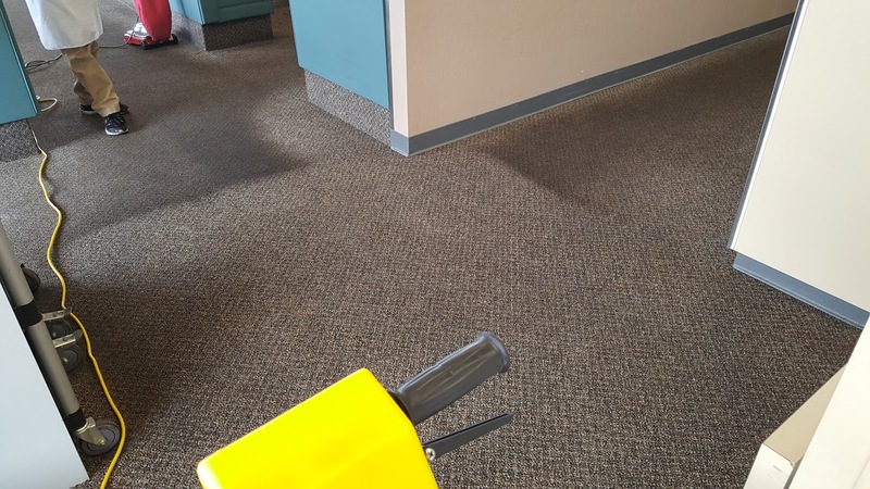

This is Cimex only..
j3m-EE3OYjqPn71xCRf6BhY7qlBl7LgTvyUtC0wPWvkWXeEDGcc5DDzijdv4bLOltHrrYc0_7E795w16vA=w1690-h950-no.jpg
They want to go on a 3 month schedule for both locations and I need to move through them quicker so my thoughts are use the Cimex with an Encap to pre scrub and use the Zipper with a detergent rinse.
