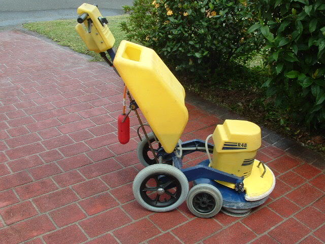

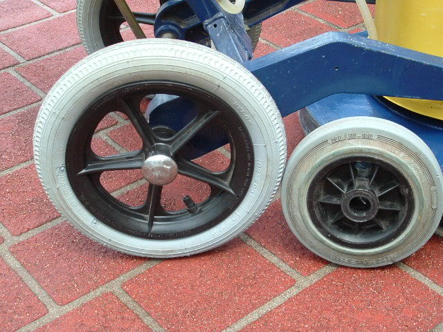

I have a Cimex and also an Orbot.
I have larger pneumatic (pump-up $Marty), tires on my wheels.
The wheels on the Orbot appear to be the same as on my dehumidifiers.
To be perfectly honest, I much prefer the pneumatic tires to those semi hard ones on the Orbot.
Here's a couple of pics taken about 6 years ago.
They will go up and down stairs much easier, no jarring of the machine or body as the tires will give, similar to shock absorbers.
Run over your extension lead & you hardly notice, with the Orbot tires, you think you are trying to get over a branch.
Push the machine over soft ground, stones or even sand with ease, try this with the Orbot style tires and you'll be in deep S**t.
I got mine from a store that sell wheelchair parts, also golf buggy parts.
Simply paid $10.00 to have the centres reamed out to a perfect size.
Hope this helps.
