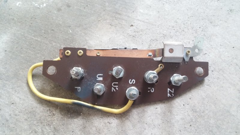

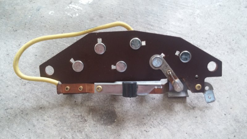

I am looking for a start board for a Cimex with the grey motor. Excellent Supply while providing great service, could not get one from Cimex USA. They do not have one!!!
The one I need has a contact point on BOTH sides of the board. The alternative is a new motor. As the story goes, for the want of a nail...

Apparently the contact points are fried. The machine will only hum when switch is turned on. But if the head is up you can spin one of the pad drivers and it will start and run normally.

Have you tried cleaning the contacts with a small file?

The electric motor people say that the board is unique to the machine motor. Cimex says they no longer have any more start boards.
