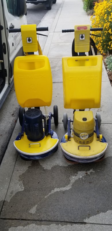

Taking turns between the two was a real eye opener..
The old unit has a very stuff on off switch, the wheels don't roll freely, the head spins loudly, it's smaller wheels make it less agile and that 10? guage tacky cord is a pita too..
But it still does the job.

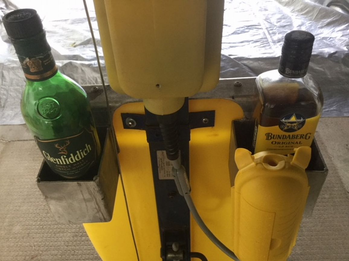

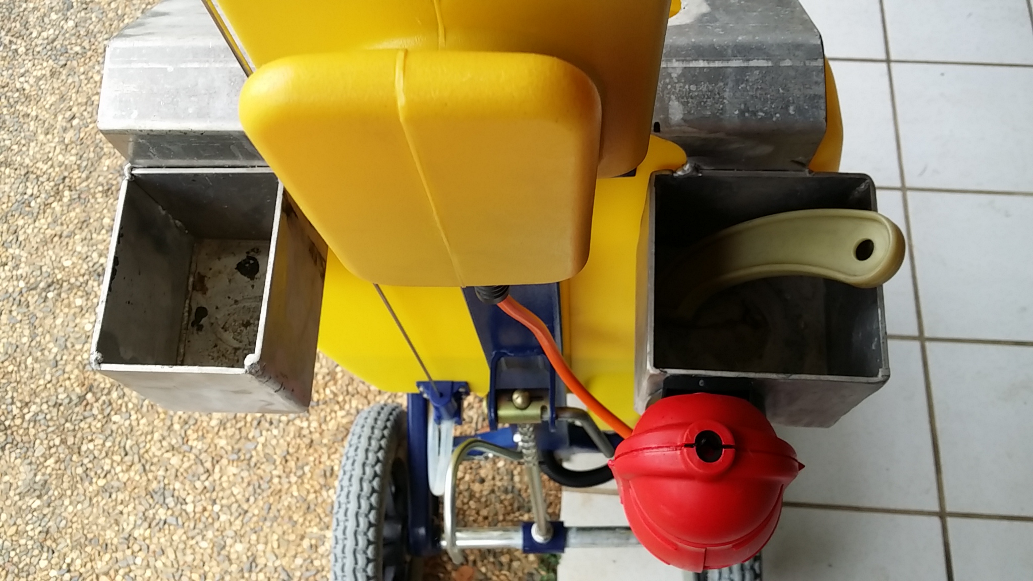

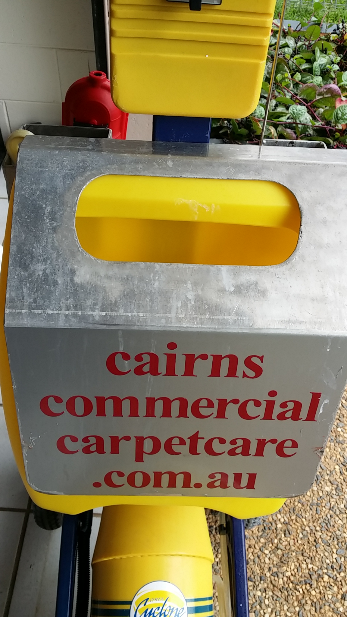

I have made a few modifications to my Cimex's.
Started with the Big Wheels, then I chopped the 50' cable and only use leads the length that I need.
Like, working on lift lobbies when a 15' lead is sufficient, I don't have 50' of cable on the floor.
I then added an aluminum plate to the front, which is one piece, & goes over the back to where I have to spotting bottle holders + the joiner box for the extension leads.
Working in the tropics, one must always be aware of dehydration, this is where the spotter holders are essential. :winky:
