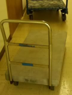

We use a plastic cart like this and stack our Buckhorn totes and water jugs on them so we can roll them in and down long distances.

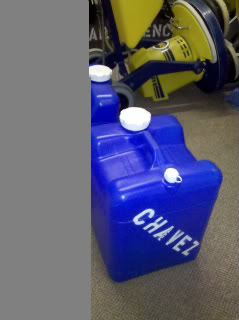

One other thing we do on large jobs is we will take 5-gallon containers with us of water. It saves time running down to the janitors closet, pour the water in the machine and add your cleaning solution.

A couple questions,
Where do to get your blue 5 gallon containers?
Is it important to keep the water hot while I run my 1 Cimex?
Suggestions on how to do that?
I think he liked our bid because he asked for references late last week. Really glad ive got Big Yella!
Thanks!
Russ
At Walmart in the camping/ out door area. No, hot water is not that important, infact we will drain our un used solution and reuse it with no adverse results.

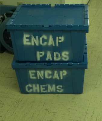

The Buckhorn you can get lots of places but Granger has them in colors. We get blue for cleaning and water damge, red for Biorecovery & Fire.
I must give credit where credit is due. The nesting totes are an idea from Steve Toburen 20-plus years old. He suggested using the with Fire Cleanup and to add a load list to the inside flap. Which we do, makes it easy to restock, so easy some of the Fire Cleanup girls will restock chems and pads when we are busy.
