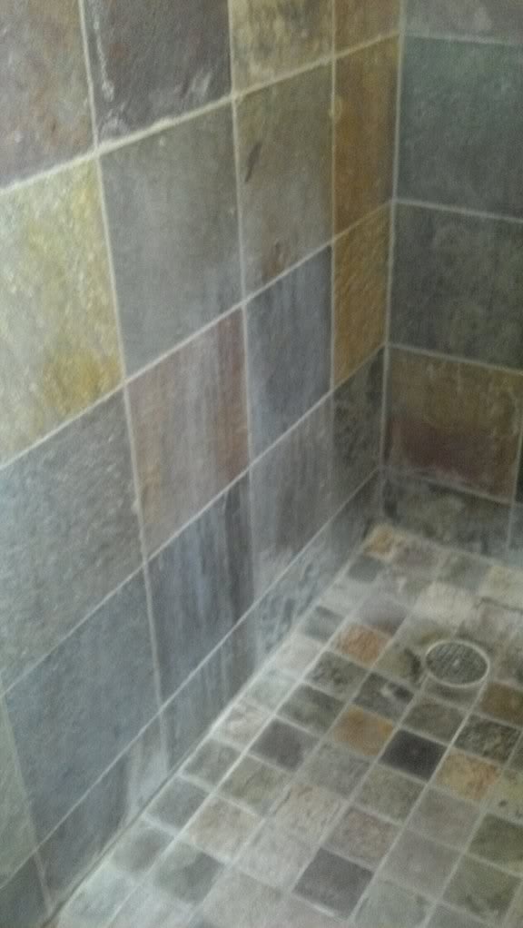

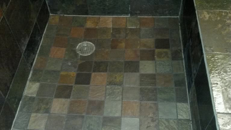

clean and color enhance
Nov 8, 2006
3,373
Albuquerque
Ron lippold
before
after
give me hard surfaces :shock: !gotcha! shiteatinggrin
GeneMiller
Mar 24, 2009
3,541
Boca Raton
gene miller
i always shy away from showers not sure what chems to use. most say will damage metals. looks great.
gene
Nov 8, 2006
3,373
Albuquerque
Ron lippold
305 husky acid cleaner its clingy and pink. does not dry out. 25 minutes of dwell. 475.00 just under 2 hours.
Bee Busy
Aug 19, 2010
799
Folsom CA
Bee Busy
how did you scrub off the heavy soap scum/deposits? I always let slate dry out 1-2 days with fans before color enhancing as well...just curious
Nov 8, 2006
3,373
Albuquerque
Ron lippold
Bill we used a product by husky #305 i believe it might be 303. Its a pink clingy acid 20 minutes dwell time, Most of the build up was calcium hard water.
Bee Busy
Aug 19, 2010
799
Folsom CA
Bee Busy
I'm always looking for new products to try out, I'll look into it, thanks Ron...for Slate showers I use a Makita and Green pad with either, Shorebest 2790, MB-3, or Meth Chloride for coatings...with a fullface resp of course :mrgreen:
ayetti
Feb 17, 2012
46
I love how it looks, I always avoid showers. I can never get good dwell time on vertical surfaces. Maybe I should consider some new chem.
alazo1
2,567
San Jose, Ca.
Albert Lazo
Yeah, that looks great Ron.
Did you have to do any scrubbing?. That clingy characteristic of the cleaner is a great idea. Wonder if they have other cleaners for stone that cling.
