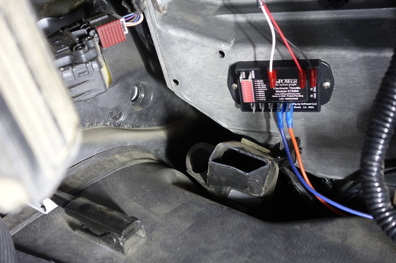

Where you have the ECU hook up there to the left ...the red wire block....
Do you have something else like an after market gps unit hooked up there.
They hooked my gps unit into those wires for power and every now and then, the gps unit searching for signal will shut down my Butler to an idle....
I just have to shut the unit off and restart....but most times it happens....it's when I am on a 3rd floor apartment building! :dejection: :hopeless:
It was not Butler that hooked up the gps there, but our local after market installers.....
Actually had it doing it to my Butler just 2 days ago.
Van was up against the side of a school building, gps getting bad signal, and it was making my Bulter RPM fluctuate....
I thought it was the Blower started to gum up.....nope....gps unit interfering with the Butler....

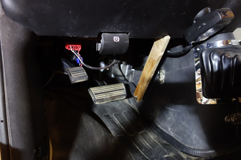

It's that red thing above the parking break in the pic..

The red plug (in the first photo) is connected to the GMC ECM . That is what a mechanic will plug his diagnostic equipment into when he checks your vehicle for codes. The leads coming out of it go to the Cleanco electronic throttle module. Its mounted above the gas pedal.
Install a push/pull throttle cable to the unit. Infinite speed control.
Not sure how that would work, tying into the efi on the 6.0 litre and running it to the panel on the Cleanco?
