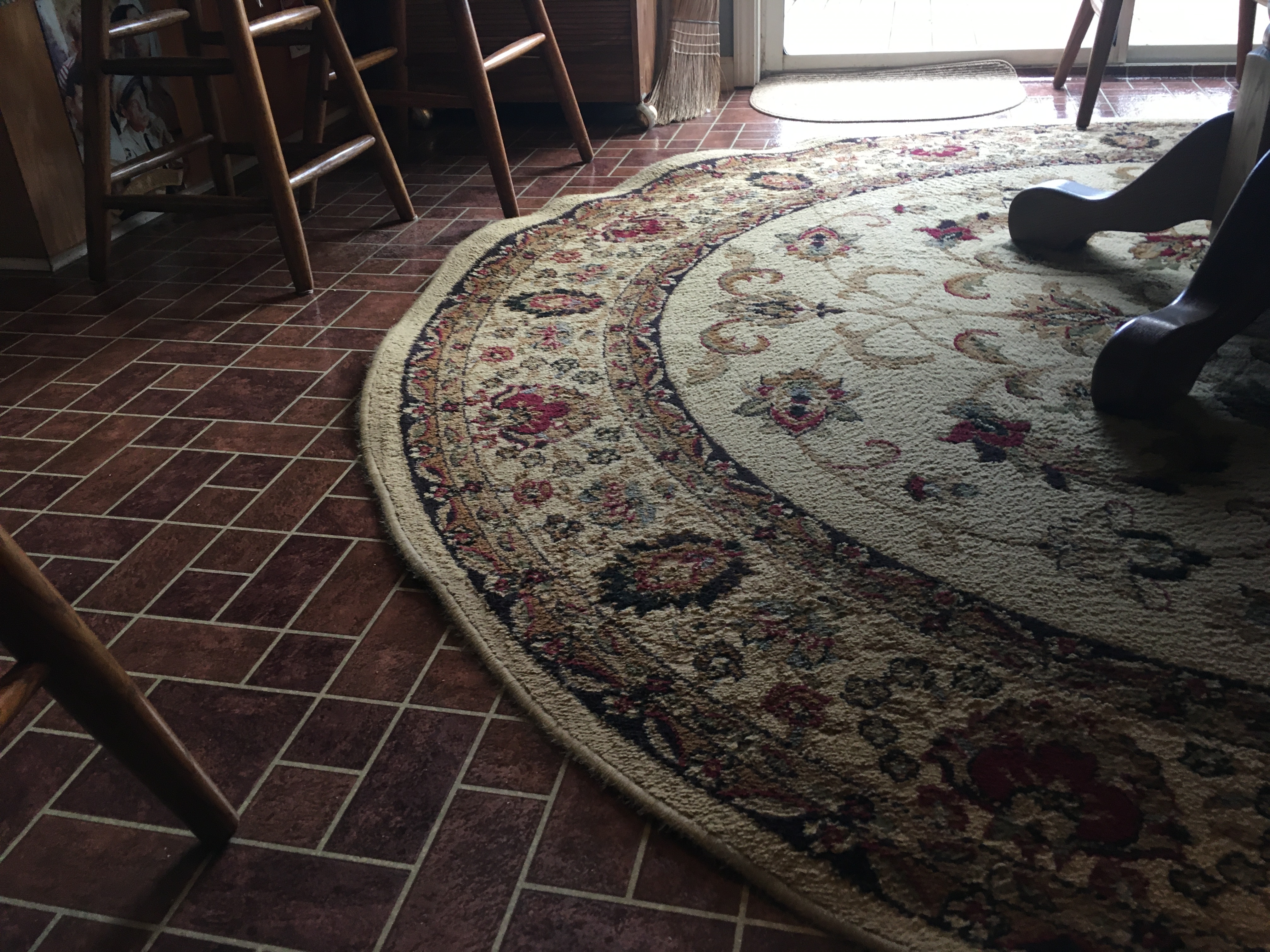

Hey guys my technician cleaned an area rug and now it won’t lay flat what can I do to correct this for my customer

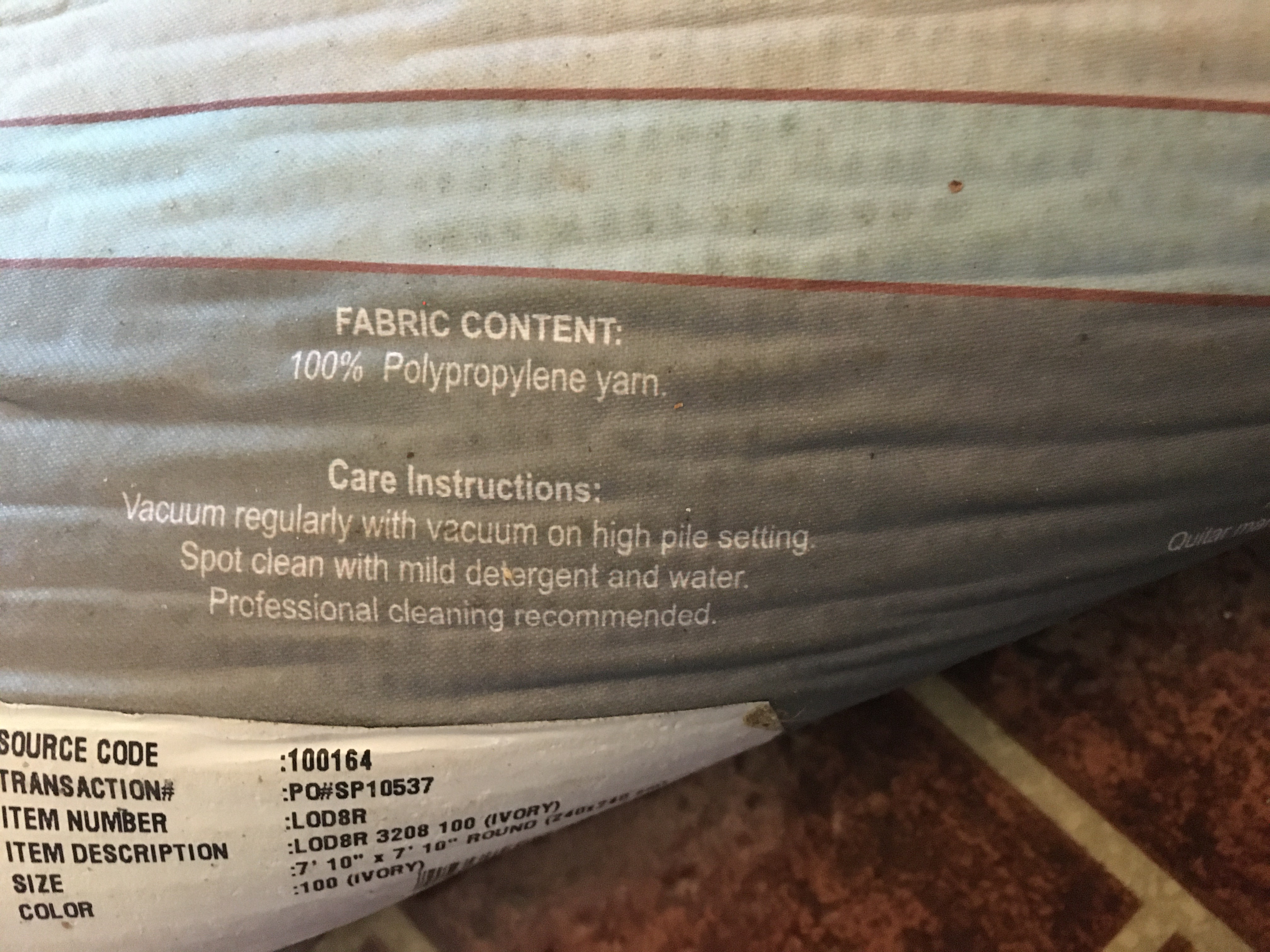

sorry I didn't include much info the rug is 100% polypropylene its inexpensive and was cleaned on site as it dried customer noticed the edges became wavy. We clean our share of rugs every year no issues but this was brought to my attention and I really had no answer. I like the idea of the clothes iron and may give it a try.

100% polypropylene rugs often have cotton, linen or jute in the backing. This is what causes the buckling. Usually it will go back down as it continues to dry. When we do these in the shop, it's common to have them curl bit as they hang on the drying rack, they straighten out.

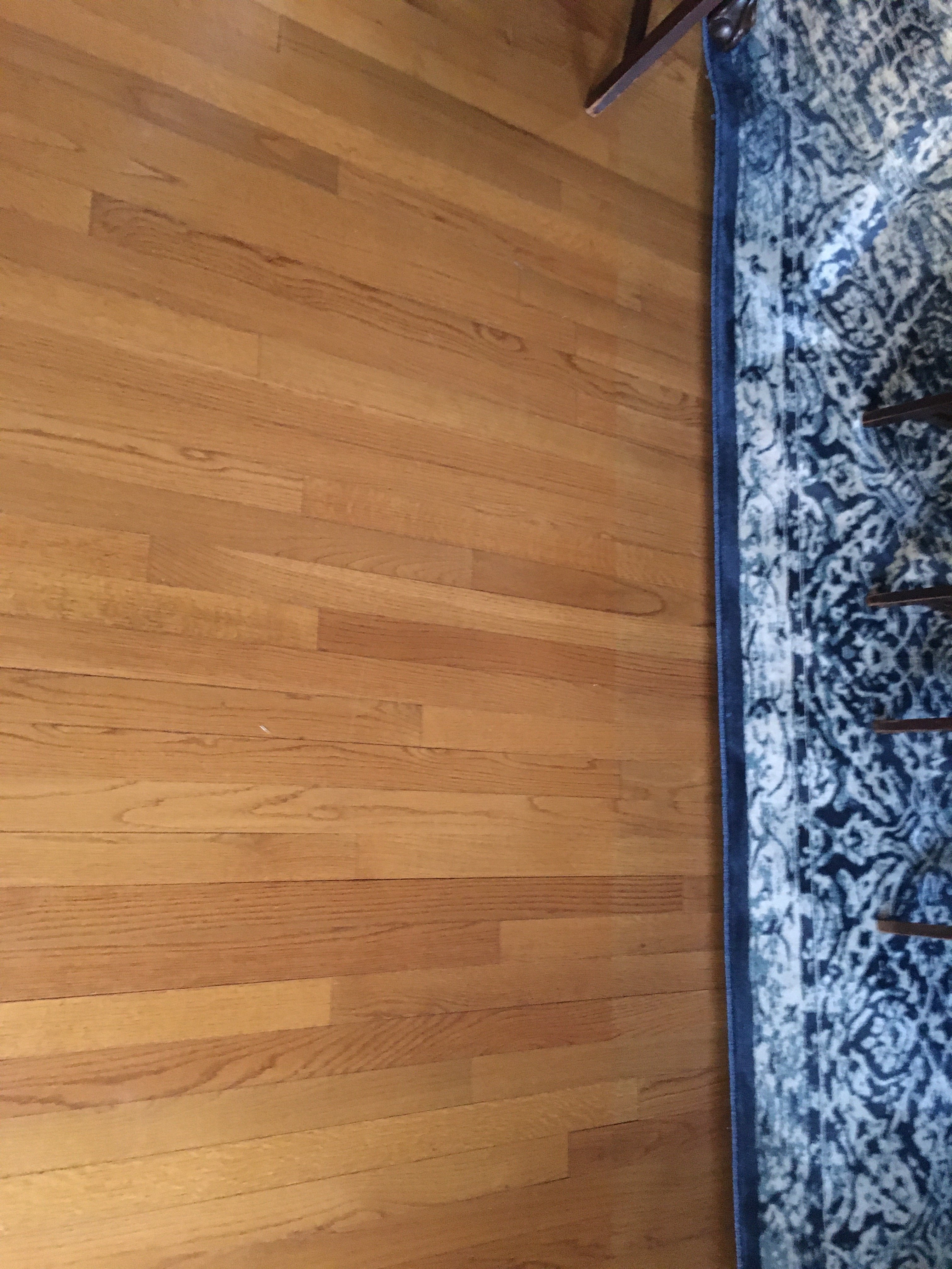

Two real scenarios. The blue rug during cleaning :
“ ma’am,can I show you this? As you know I had to use water to clean up the spots on the rug. This buckling is from the cotton that’s weaved in the backing. It does this when exposed to moisture. Give it a day or two and it’ll relax.”
“Ok, no problem”
Next one:
“From the flushing method I’m using...it’s causing this polypropeline to buckle. It’ll relax back down once it’s fully dried. Just please watch your step when you walk around it.”
She accepted that explanation.
And don’t give me any excuse for saying encapsulation would’ve prevented that. It started buckling almost right after I put a light spray on it.
