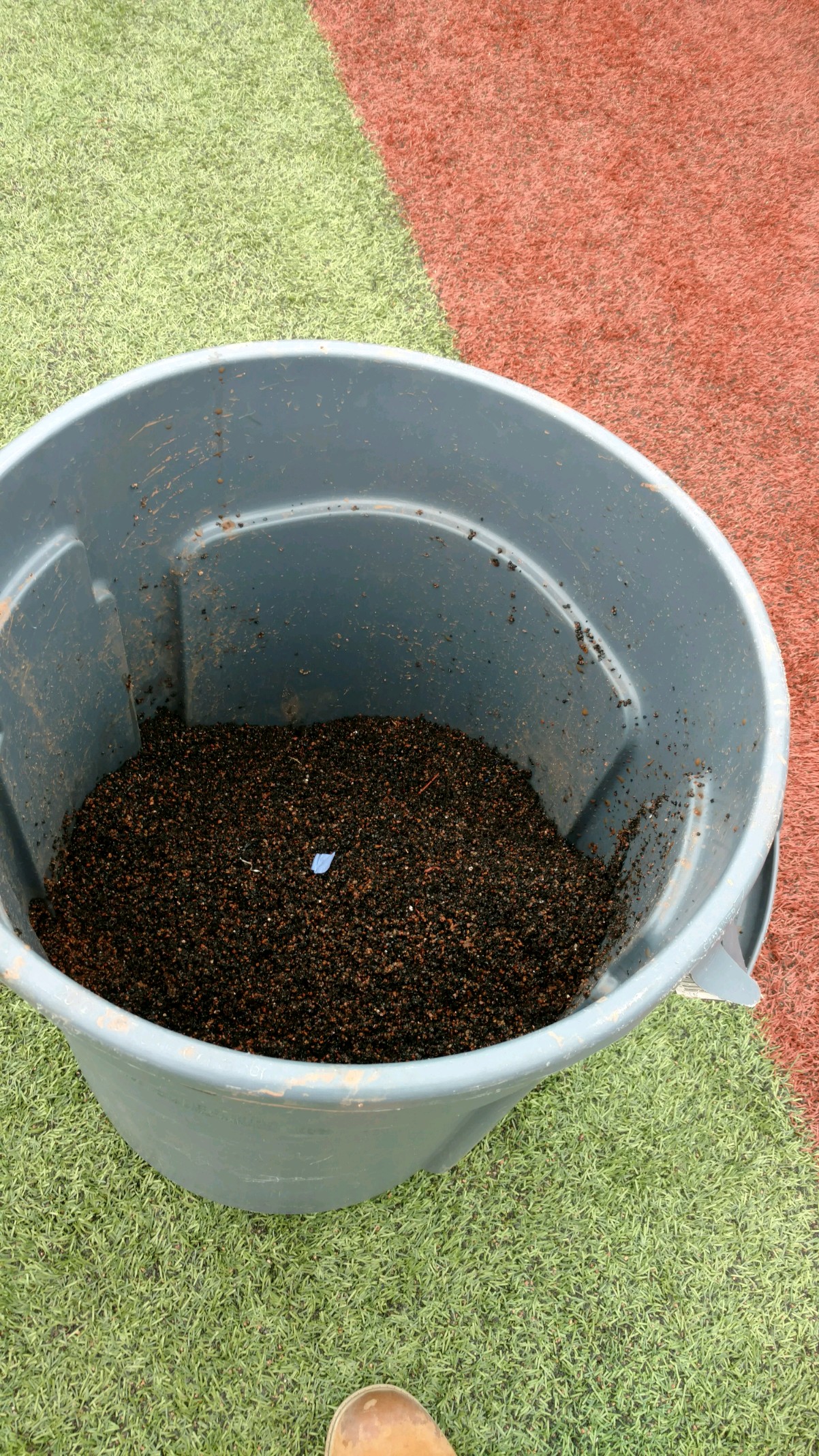

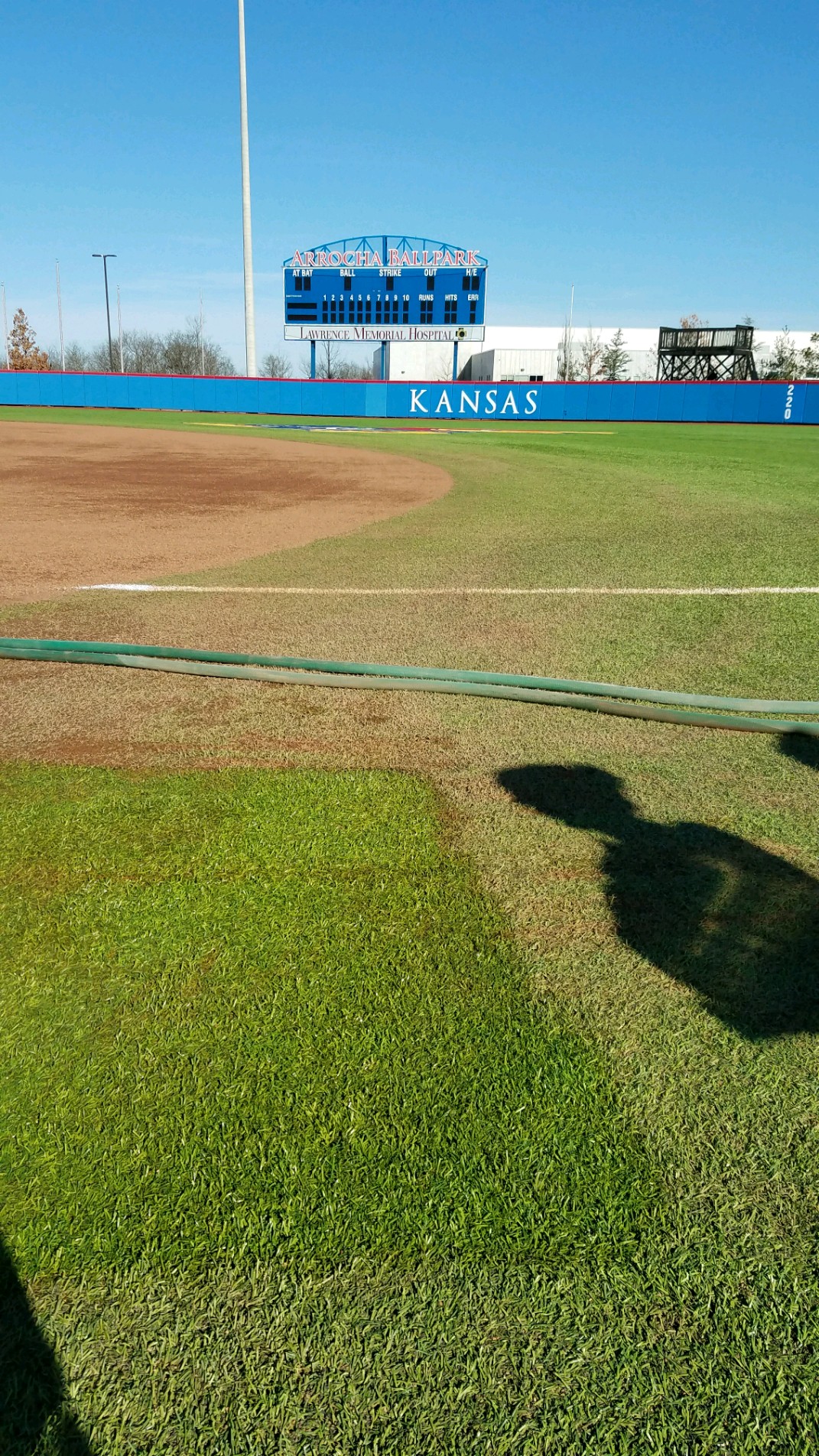

We cleaned the infield and anywhere the clay had discolored the grass. The pellets were a huge problem. We tried several filters but ended up just letting it fill the recovery tanks. If we do it again in the spring they plan to try 55 gallon barrels.

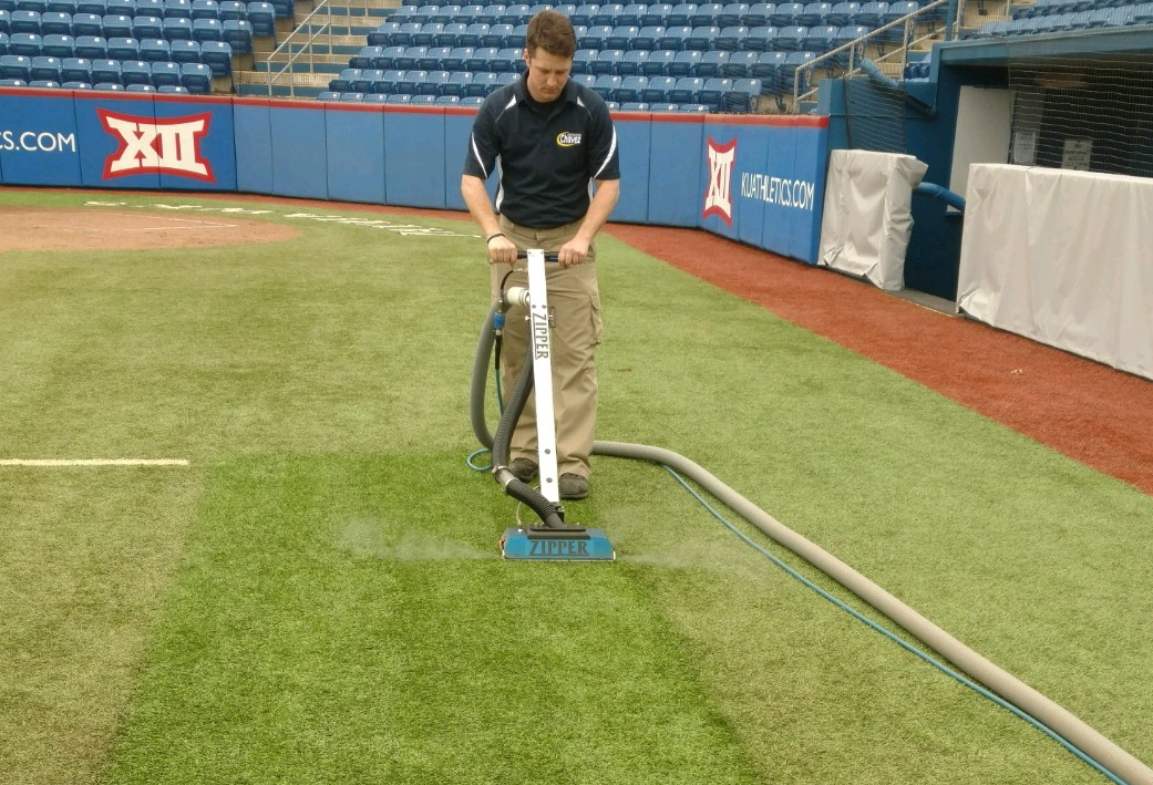

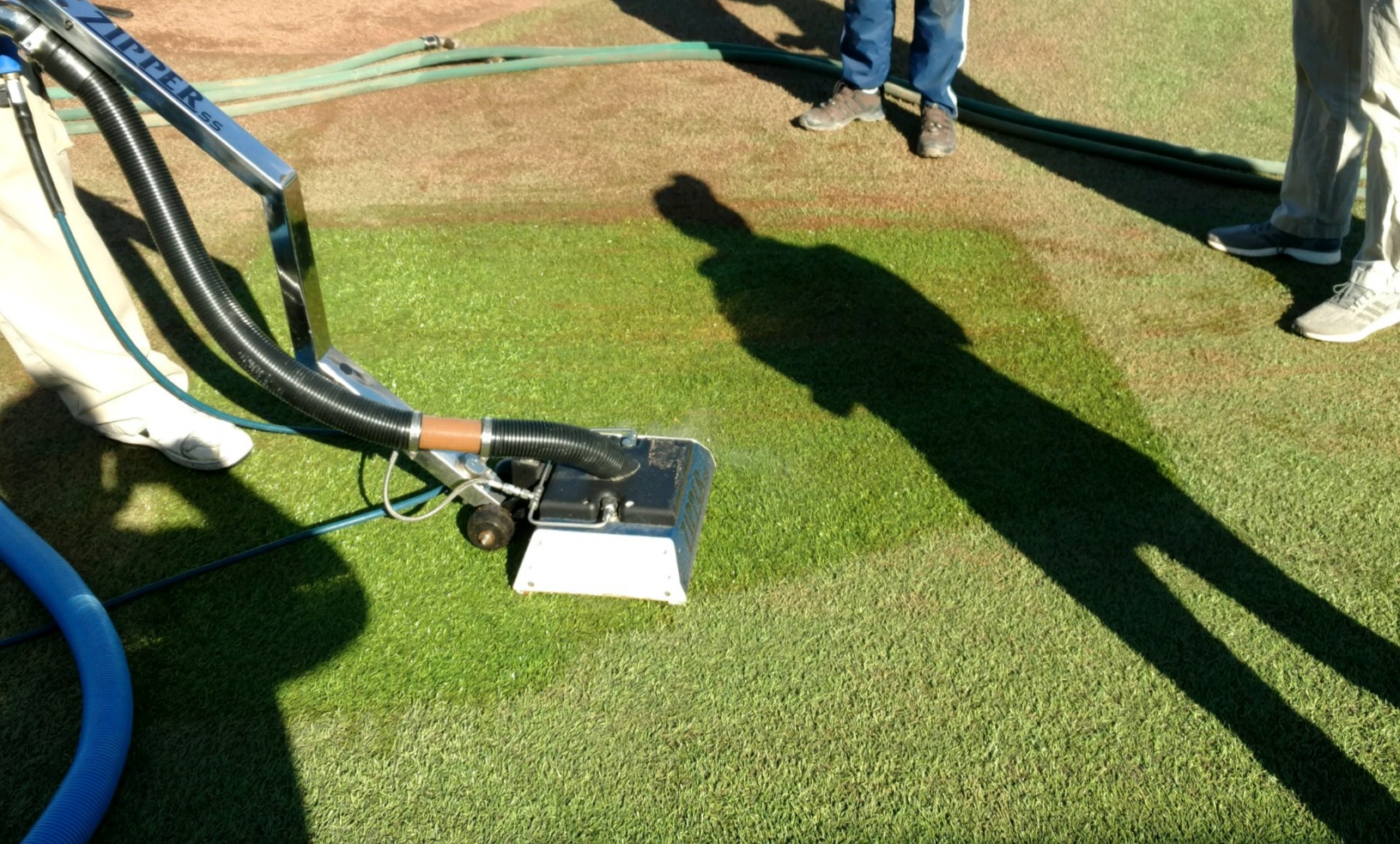

We simply steam cleaned with Zipper Spinners, plain water. In really impacted areas, we pressure washed and extracted to remove the clay.
View attachment 86427View attachment 86428View attachment 86429View attachment 86430

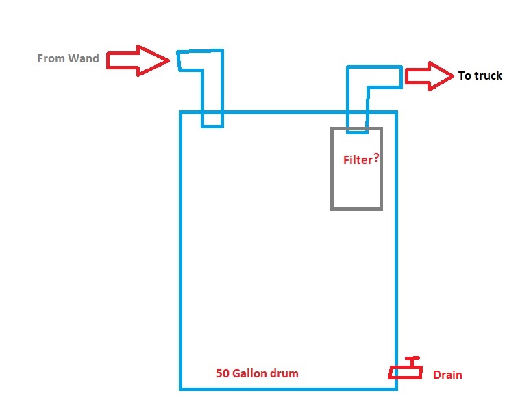

Erik Hiltz (Zipper) suggested a PVC port on each end at the top. The idea being the solids drop and water pulls straight across.

the 50 gallon drum would act as an inline waste tank/filter. You would put an inlet and outlet fitting on the lid and place it between the wand and the truck. Probably still needs some type of screen filter/baffle attached to keep any crumb rubber from making its way to the truck's waste tank...but maybe not.
I don't know that the water would just pull straight across though
