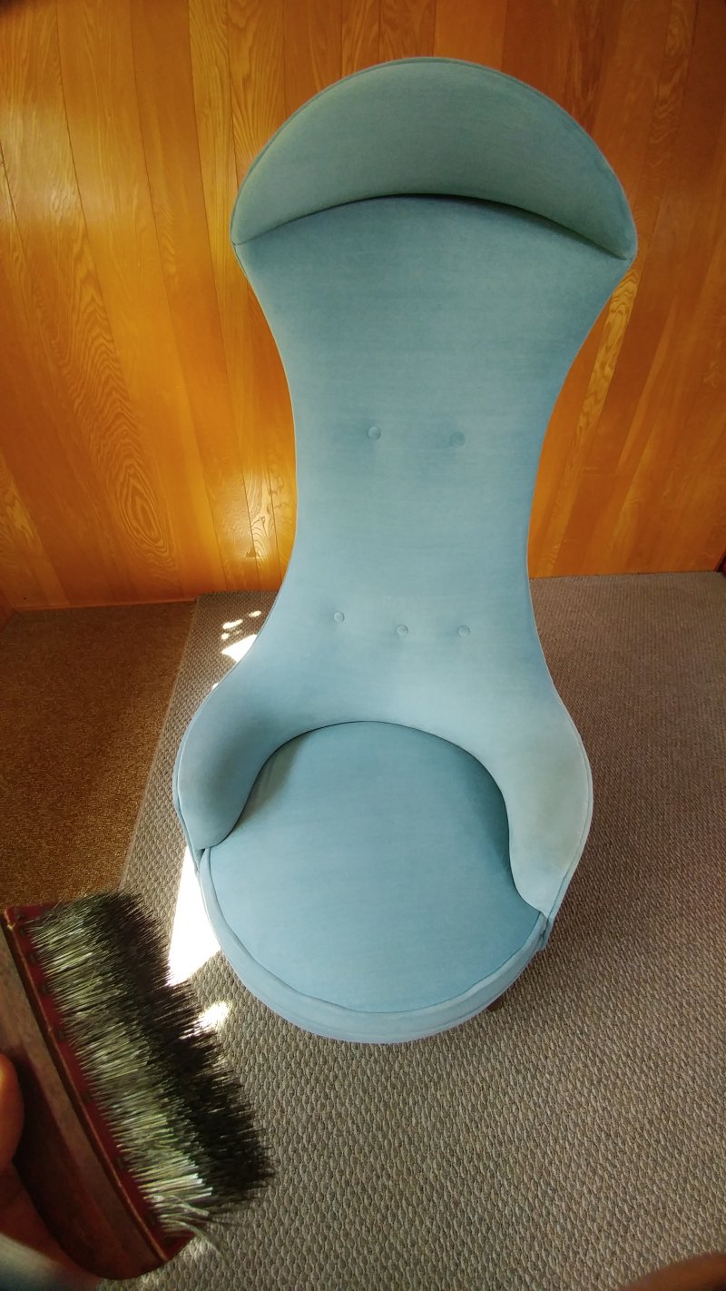

I love cleaning velvet. Use a gentle cleaner, I use Judson O2, vac, prespray, gently scrub, rinse and brush it out. They look great after. Don't see velvet much anymore, just cheap microfibre. This chair is from the 70's

I agree with Mike. I would not use on upholstery as IMHO it will require heavy rinsing. Better products available.
In addition to what others said:
When cleaning velvet, clean (move tool) with the nap direction.
Do not do back & forth movement with tool.
Groom to each sides and last with nap.
