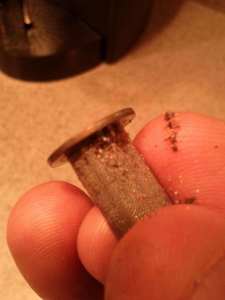

Ever since I got these 2 EagleWash hoses my wand has been clogging up to the point that I have to take the small filter out and clean it, I get barely any water coming outwhen it happens.
4 times since April.
It happened maybe once in 5 years with this Prochem wand.
Has this happened to you?

Try putting a garden hose screen in you feed hose man!
Holy Cripes them look like lil rocks n stuff.
When you use a spigot, let that thing blow chunks for 10-12 seconds before ya go hooking it up.
Or jus clean the dang thing an rock it : )

If nothing else has changed, obviously it's the hose
flush your line at start up for 15-20 seconds or so before hooking to the wand

If the new hose was the problem the debris collected in the filter would be black, or at least a uniform color. Do you run a fresh water tank?

well water??
everyone should put a stainless wash machine inlet hose inline...they cost about a buck twenty-nine!
