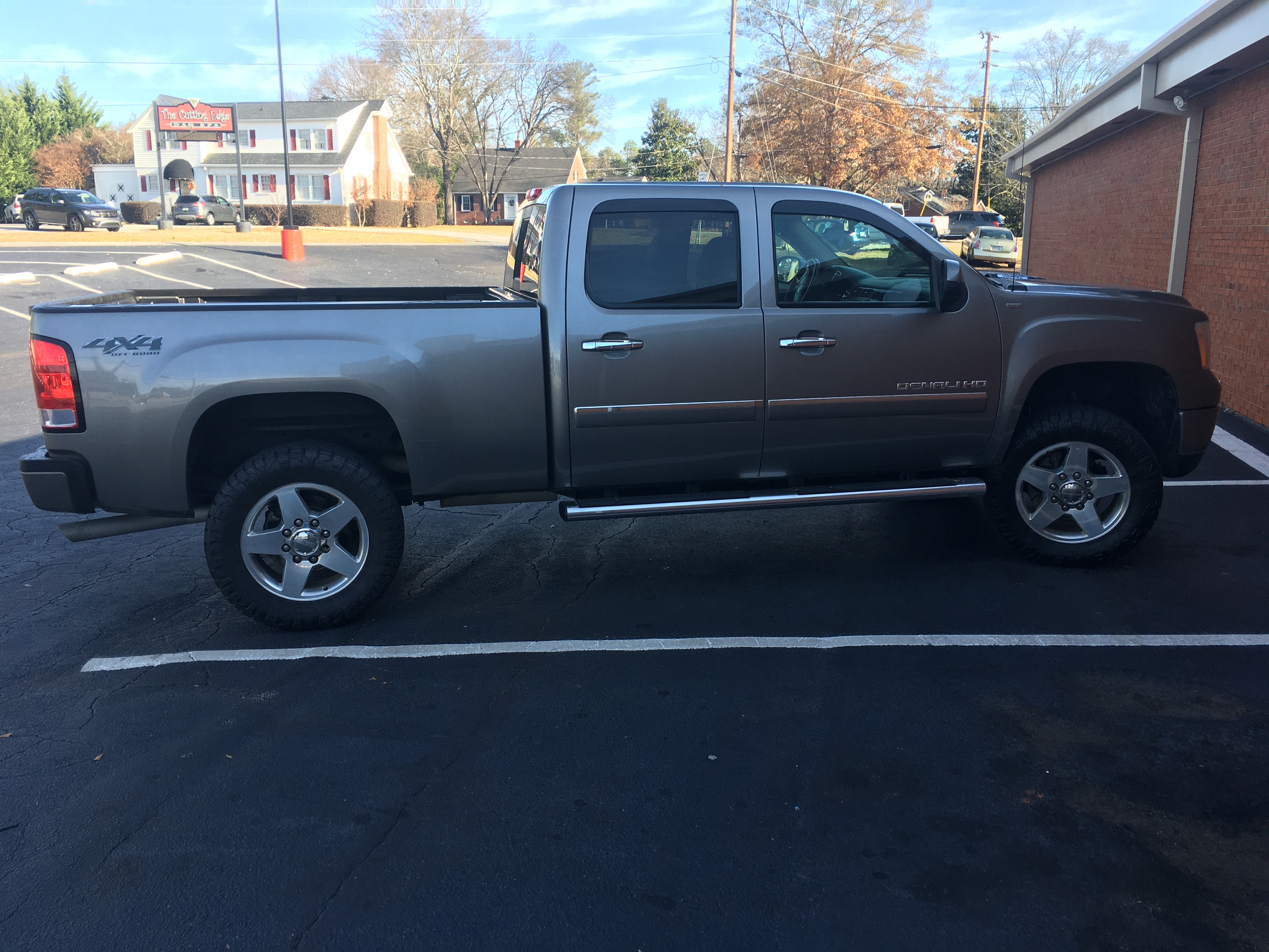

The truck I just bought has everything on it for CNG except the tank. I'm wondering if I should just leave it or put it to work with CNG. Besides emissions and maybe cheaper insurance, I don't see any other benefit. What's you guys' thoughts?
Here's what's on it:
prinsautogas.com
Prins Auto Gas System B.V
model VSI CNG Vapor Sequential injection
I'm gonna give them a call next week and get their input as well. Just wondering what other opinions from the consumer's thoughts are compared to petrol gas
14,477
My main question right now is MPGe compared to MPG on unleaded.
the way this is set up is it can use both gasses and when one tank gets empty, just flip the switch to the other fuel.

There is already two fuel tap lines routed to the bed of the truck where a tank was there from the previous owner. I have some questions that I’m going to ask a CNG technician when I want to purchase a tank.

The tank will be bolted to the front of this truck bed
