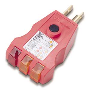

Steve, do yourself a favor and get yourself one of these:
It will alert you to a miswired receptacle, in your case - a hot conductor wired to the neutral side. Less than 10 bucks at any of the home centers.

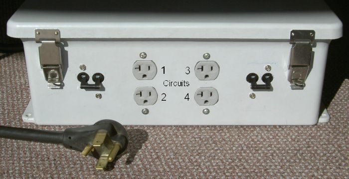

Jim;
I'll send you some photos of the interior of the box.
I have them at work.
Here is a photo of the fiberglass exterior:
Notice the commercial 20 amp receptacles (same plug style as your photo)
Larry
