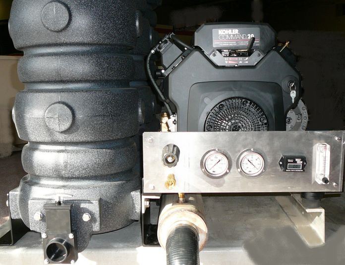

Here is a photo of the prototype 20 HP DC2045. #4MP Blower & 1500 PSI HX.
It has been refined in a few respects from this early photo.
Larry

Thats a great looking design. Do you have anymore pics? When is the release date for this machine?

Larry, it looks good.
I would like to see you move the hour meter up a few inches on the face plate and add a temperature gauge on the face plate.
ahhh missed the temp guage easy fix....I would add that fer sure.

Brent;
The prototype has had a couple of revisions.
Now, we are trying to decide the final location of the recovery tank...
On the left, as in the picture,
or on the right, which would be just behind the front seats in a van.
Larry
Larry Cobb
5,795
Larry Cobb
The prototype is bolted to the recovery tank mounting brackets to save floor space.
They are 1/4" steel, so they are easily capable of supporting one half of the mounting plate.
The mounting plate can be mounted as a separate assembly on 4 supports.
It takes up less floor space with the recovery tank on the left,
but the mounting plate is less subject to damage with the recovery tank on the right.
Larry

I think on the right behind the seats of the van would be better. Because the tank would have somewhat of a heat shield effect and help keep heat out of the front of the van after a cleaning job.
