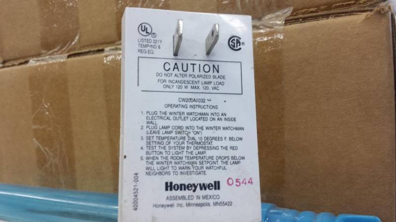

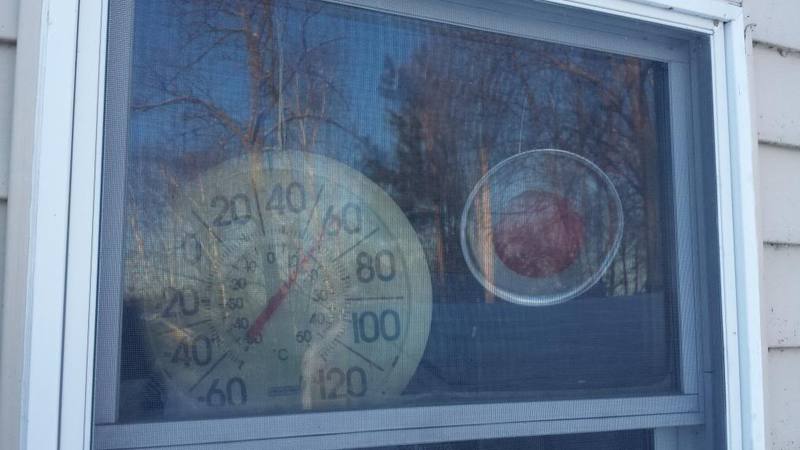

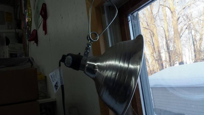

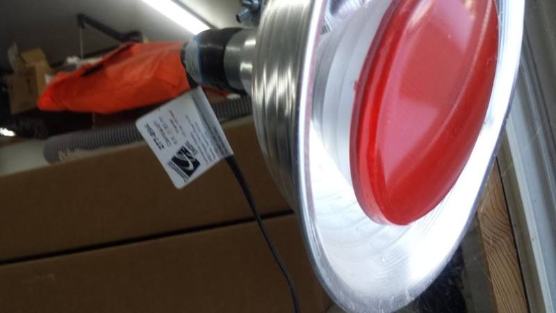

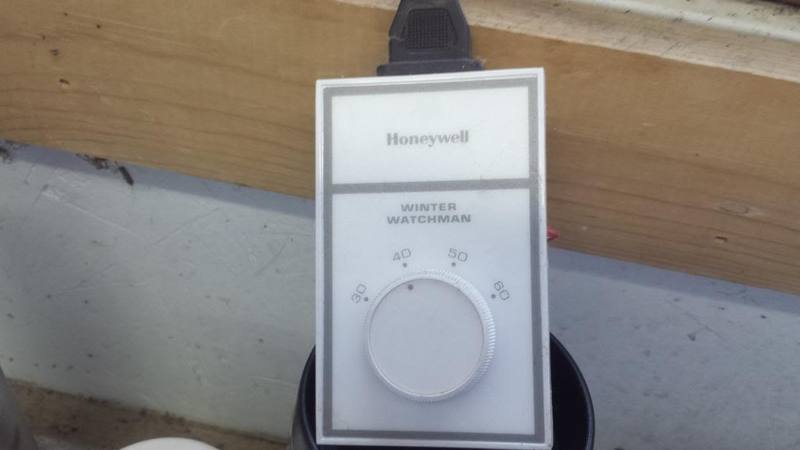

Just had a call from a cleaner in St. Louis who is really taking precautions to winterize and protect his cleaning van. He got me thinking and it might have been mentioned, but make sure if you are using ceramic or oil filled radiator units, make sure they are on separate circuits.
Also, here is a cheap little $23 safety warning unit that you can use. I have one in my shop in case the main heat goes out (but I also have 220 volt 8 foot electric baseboard back up heaters installed all around the shop).
Here is a link to the unit which is a Honeywell winter watchman: http://www.homedepot.com/p/Honeywell-Winter-Watchman-Temperature-Signal-CW200A/100476732#
Here are my pics of it's set up on a RED spot slight and my unit is set to go off at 42 degrees in my particular application.
Plugged into the wall socket:
Front of unit:
Back of unit:

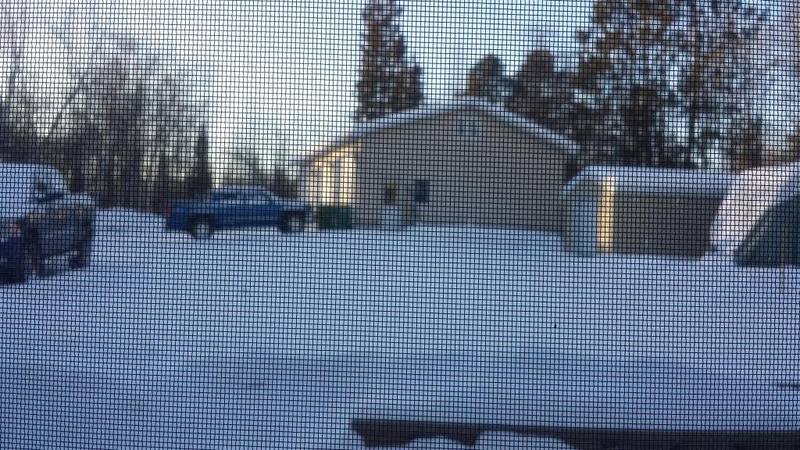

View from my home office window (through the screen too) and easily seen if it goes off (even our Schnoodle sees it and let's us know....good dog!)

Mark your light is genius.
