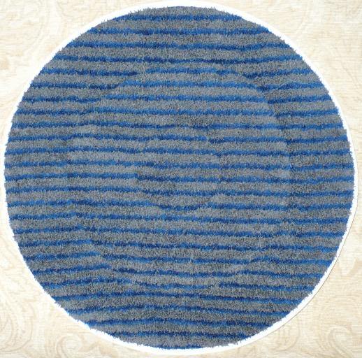

I would use the newest microfiber pads for better adsorption with your 175 RPM machine:

I like that bonnet Larry. I have some blue micro fiber bonnets but they don't have the stripes, tell me about that bonnet

Steve;
It replaced the all-blue microfiber types, which were too spongy.
It scrubs better, and looks to be more durable in the laundry.
It could even help that Vortex.

Larry, are you manufacturing those pads? How thick is it?
