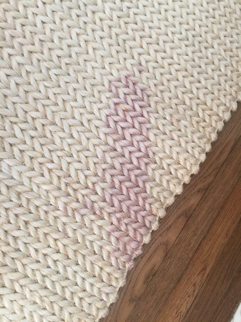

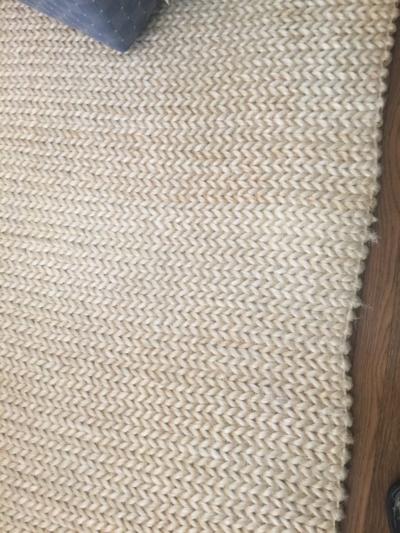

View attachment 2152View attachment 2153View attachment 2154View attachment 2155
I played around a few a couple of weeks ago. I have done a couple of spots here and there, but by no means would call it an income source. These were nice and easy because they were white and not yellow. They were caused from an "oxy" cleaner by the homeowner. I did these three, plus 2 more in another area.
I have never cleaned over one of these, maybe should do some on a sample and clean them to see what happens.
It was pretty easy. I played around with these and other dyes at Summerfest last year with Tom C. It was fun to see the reaction of the homeowner as they were disappearing. :headbang:
