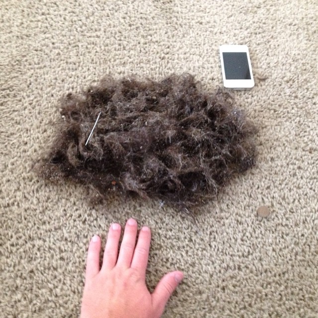

This is from 1 living room. We always pre-spray with the CRB, brings up more than going over it dry. (Phone didn't get pulled up with the CRB, just there for example of the amount of hair removed) :)
