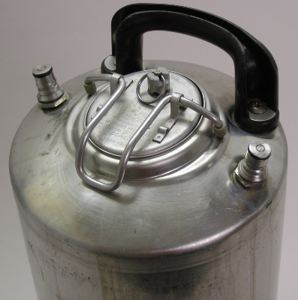

I don't want to use in-line sprayers anymore so am thinking of either going with a battery sprayer or a compressed air Pepsi type sprayer and would appreciate any positive and/or negative feedback on either of these type sprayers from anyone using one or the other for applying pre-spray.

The bad thing I heard about the pepsi sprayer is the hose breaking and making a huge mess by spraying everywhere. I use a omni battery sprayer. It works for me.

I never understood the appeal of pepsi spray cans.
(they were once a BB de juor item.. :roll: )
they're stupid heavy, you need a compressor on board to re-pressurize them and the valves have been known to pop off the top and spray juice all over Mrs Phiff's ceilings....
NO THANKS
buy a good corded or battery electric sprayer ....leave the pepsi cans in the soda fountains

I have been using pepsi sprayers for years and have had no problems I see the ones bitching about them have never used them.
just like any tool needs maintenance you know like replace the hose every ten years if it needs it or not.

We sell both the 5 Gallon Stainless can and Mytee's Boss electric sprayer.
Our 5-Gallon is the lightest sprayer you can carry for the capacity.
Stainless resists many different chemicals.
Wide-mouth is easy for mixing.
The sprayer itself is relatively trouble-free.
The air compressor needs to be high-quality for long life.
