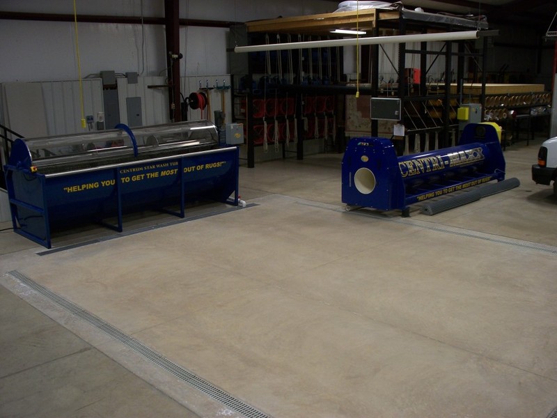

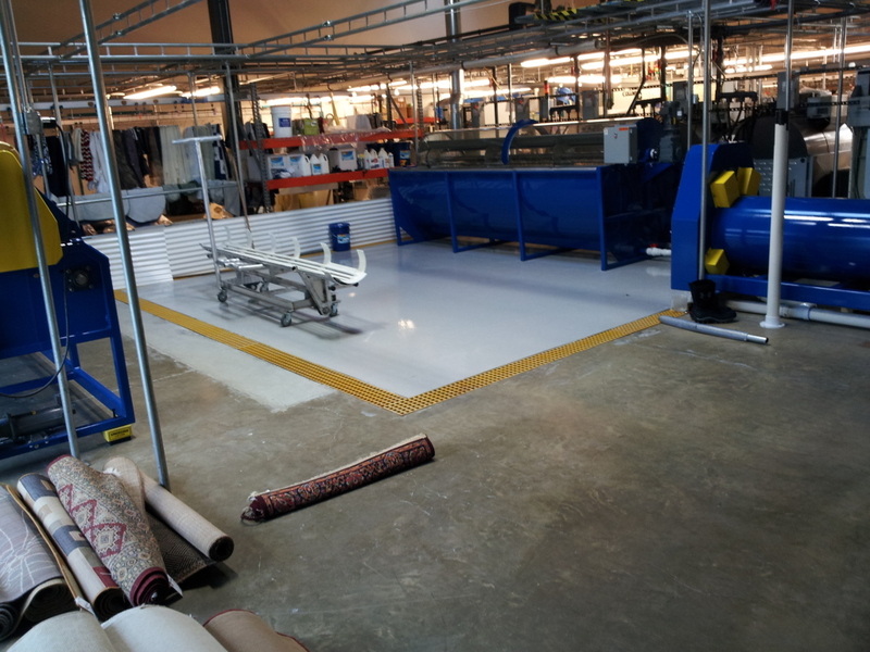

Check this clean look out:
There are no curbs to bump into. Lot's of wash floor area. Drains well positioned. This owner studied many plant layouts before he committed to this layout. It's really practical for what he does. Good job Rodney!
Jeff Madsen
Dec 16, 2006
345
Lincoln, NE
Jeff Madsen
That is a sweet looking shop! I wonder what that set Rodney back between the equipment and the floor. Whatever the amount - that sure is pretty to look at!

I don't quit get the flat floor option...
why isn't the water going all over?
Rodney says, "The floor is slightly higher in the center so the water flows all four directions to the drains of the wash floor."
Robert Mann in Denver has his entire floor sloping the same direction to an in-floor drain system at one end of his shop. Others I have seen, make theirs more like what Rodney just completed. I have a curbed concrete pit that slopes all one way to a drain that is under my wash tub. The curbed pit was already made before I started Centrum Force and made wash tubs. Otherwise, I would have done the flat floor with drains cut in the floor as pictured.

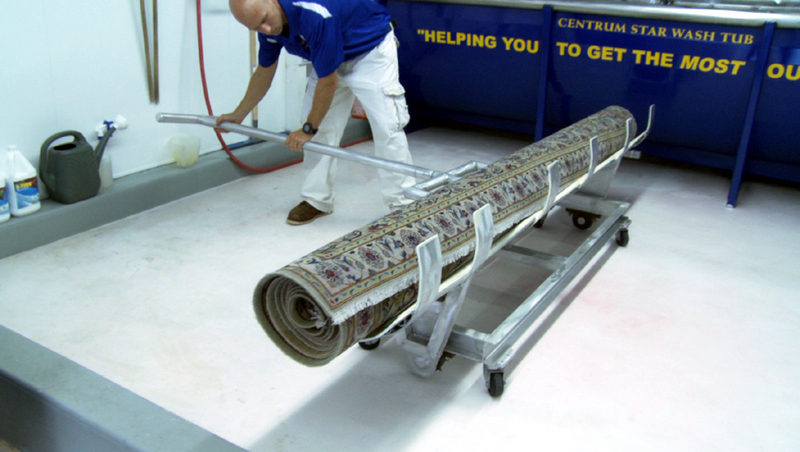

A curbed concrete wash pit is real easy to form and pour on top of an already existing floor. (I credit Randy Hyde for that tip) That is what I did. I prefer that over rubber types.

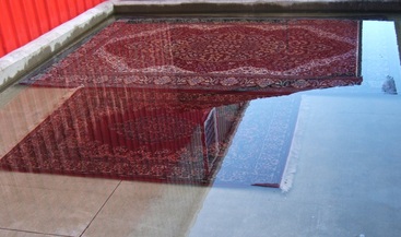

This is my curbed wash pit:

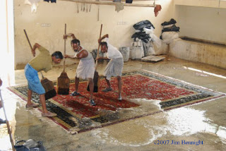

Our wash floor is 20 x 30 during the summer I wish it was much bigger I wash as many as I can fit on the floor at a time sometimes that's 8-10 rugs or one really big rug there are also 4 rugs I can't wash for customers in town the smallest being 28 x 35 ..suck mopping doesn't cut it!
I can't take credit for the floor idea I got the idea from Talisman in Santa cruz

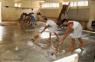

Not only is it interesting to talk about wash floors, but also the tools to be used on rugs while on the floor.
Time honored ones featured here:

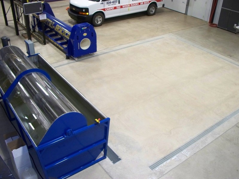

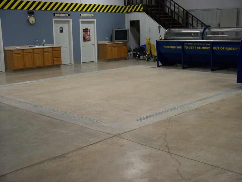

Here is another concrete floor with perimeter in floor drains:

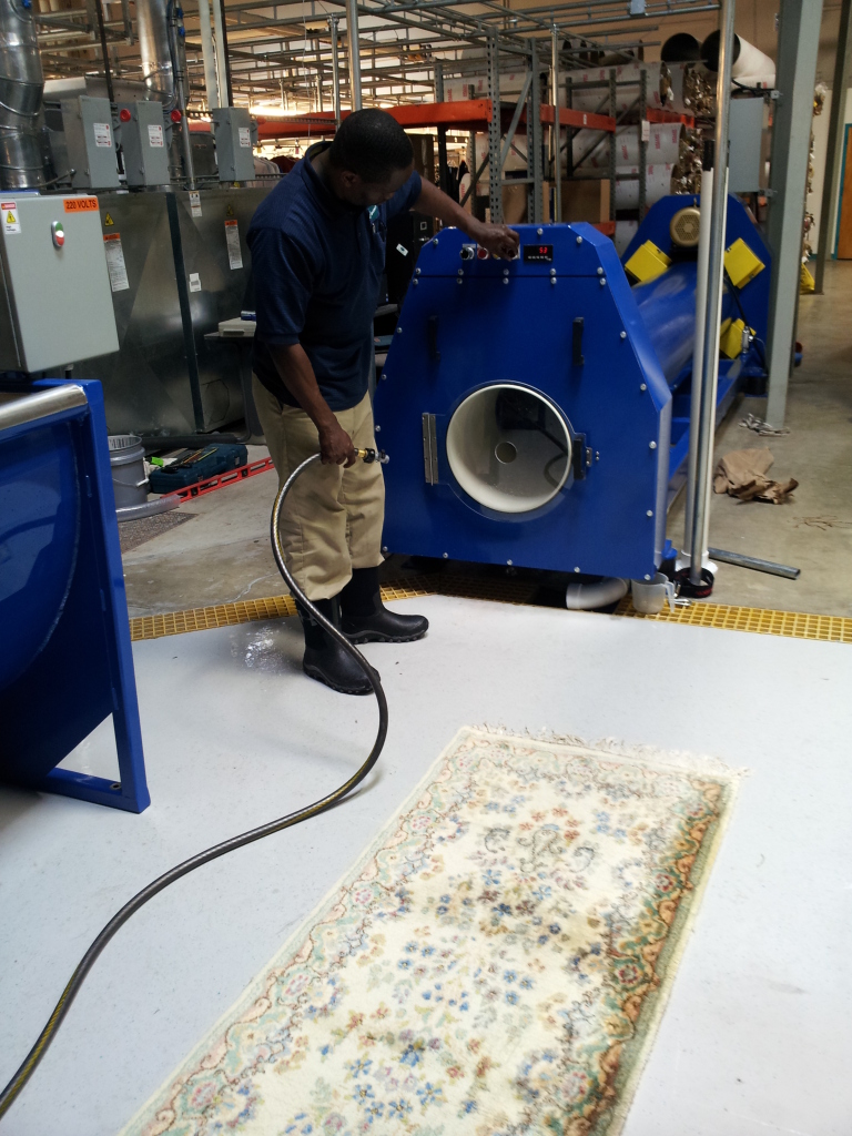

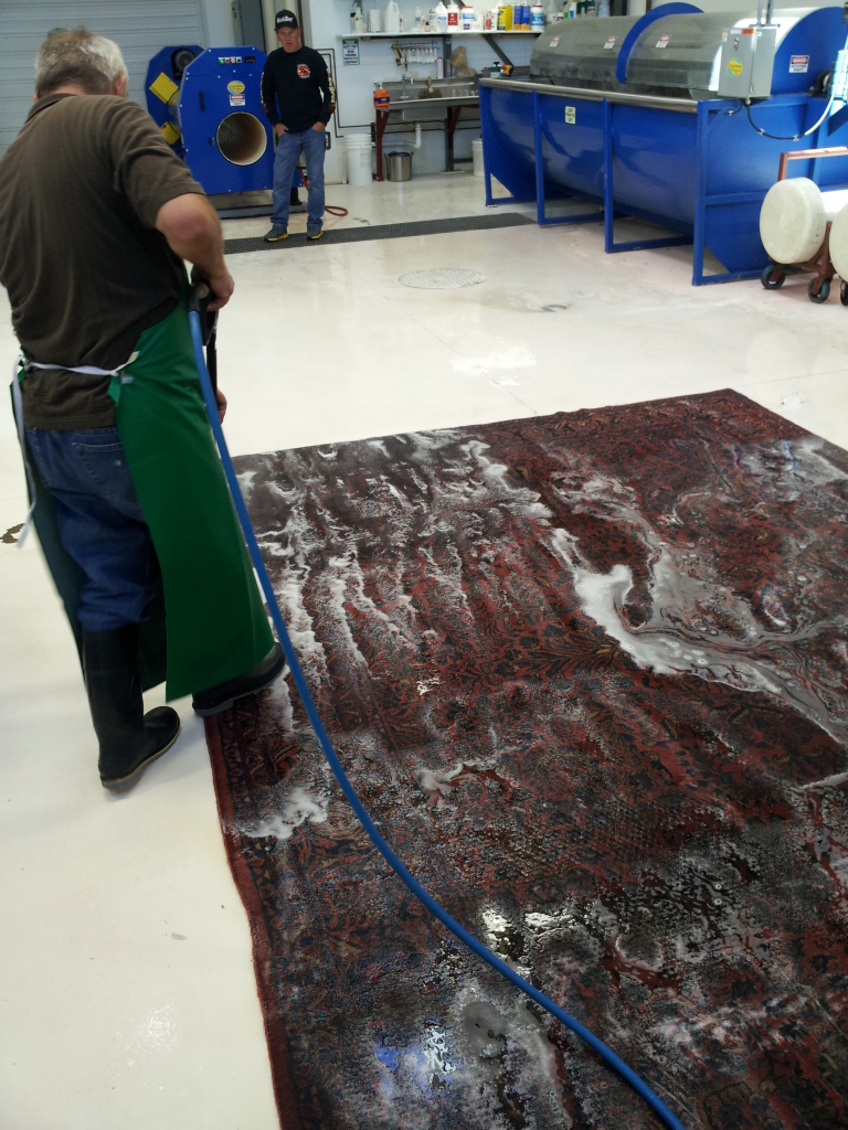

This company uses a sloping concrete floor down to an in-floor drain:

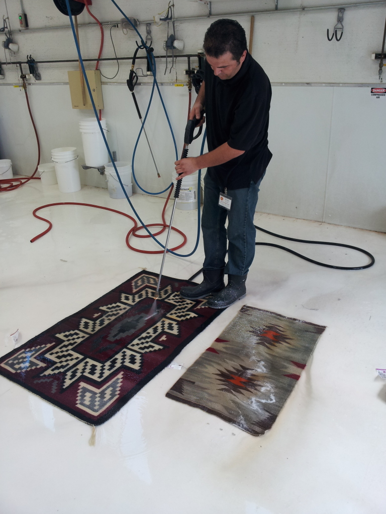

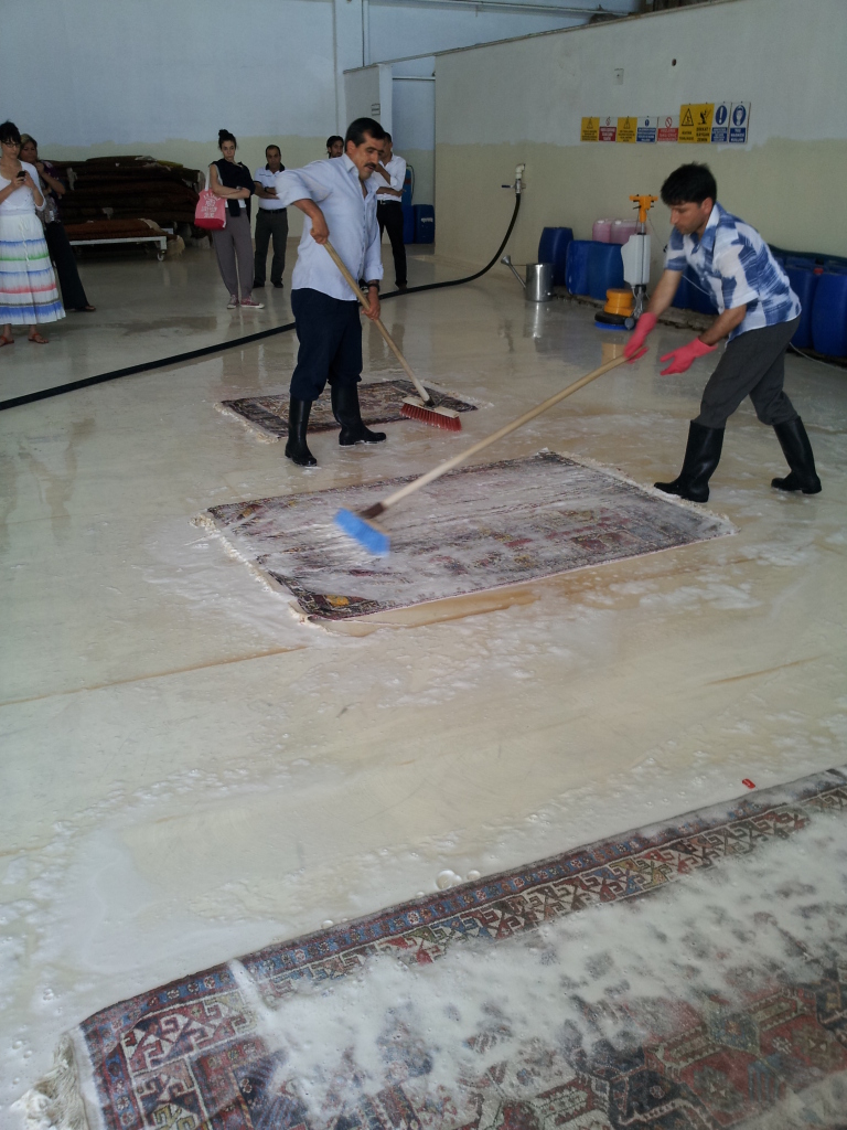

This picture was taken by me when I was at Woven Legends in Turkey. They have a sloping concret floor to an in-floor drain too:
