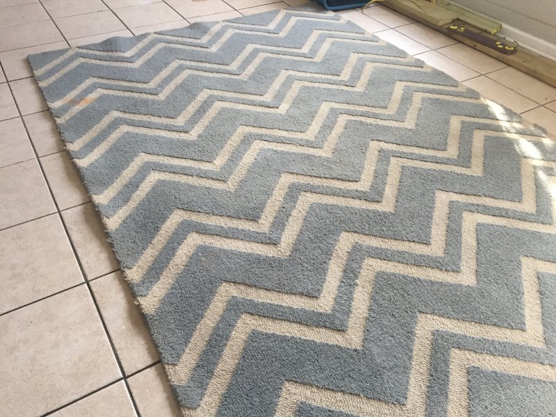

Here is how it looks. It was light blue with off-white stripes!
Incredible, I don't believe I've ever seen a drastic color change like that on a rug. Upholstery yes, and it was a strong ammonia precondition (high ph) that burned it. Two beige chairs and it turned them pink. Misted with an acid and wiped to correct.

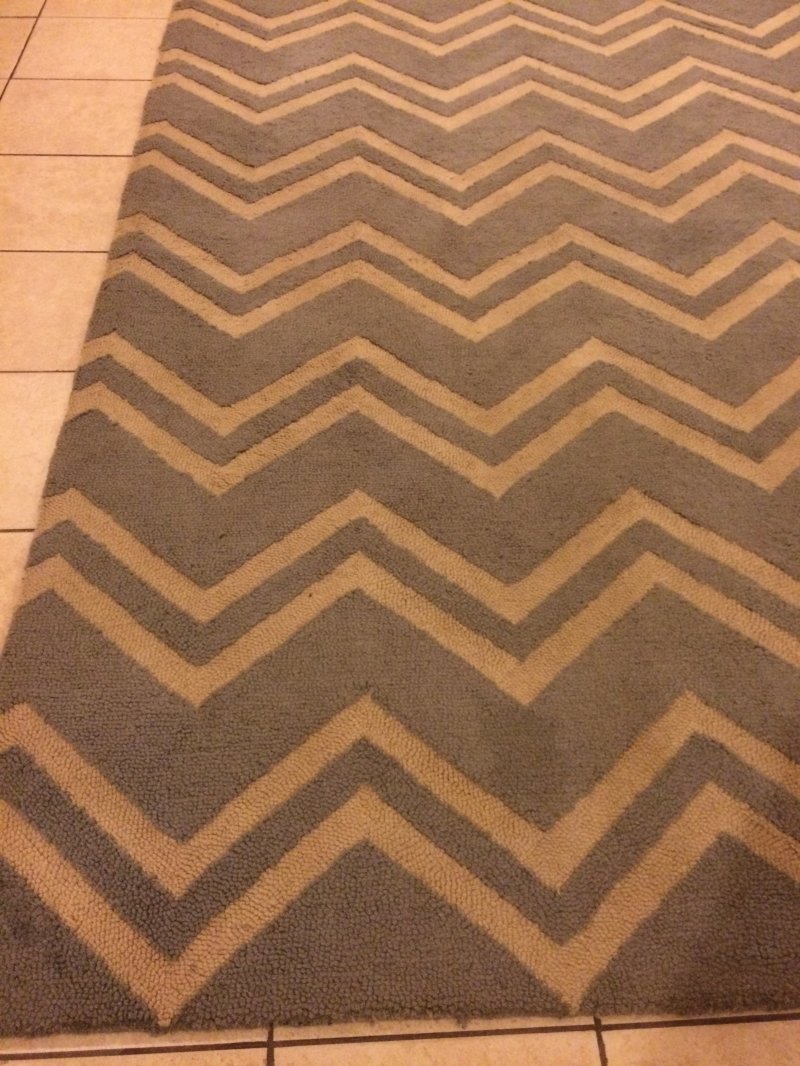

OK. So you basically did everything I advised you to do.
Nice work. Rug looks very good now.
