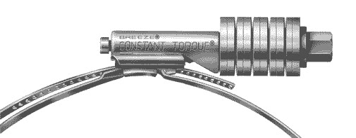

clamp
take a look at this clamp
http://www.breezeclamps.com/ct.htm

Nice! I don't recall ever having a problem with standard worn gear drive clamps except when I strip them when over tightening.
