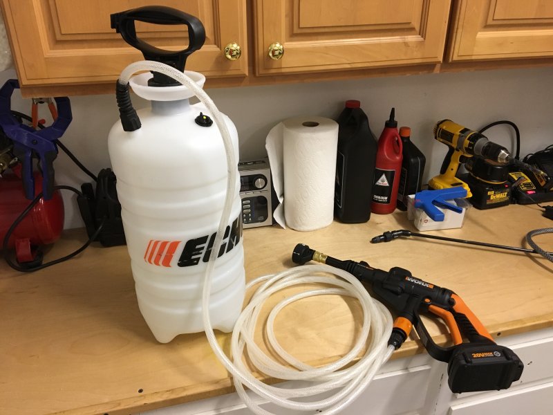

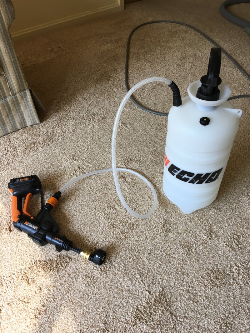

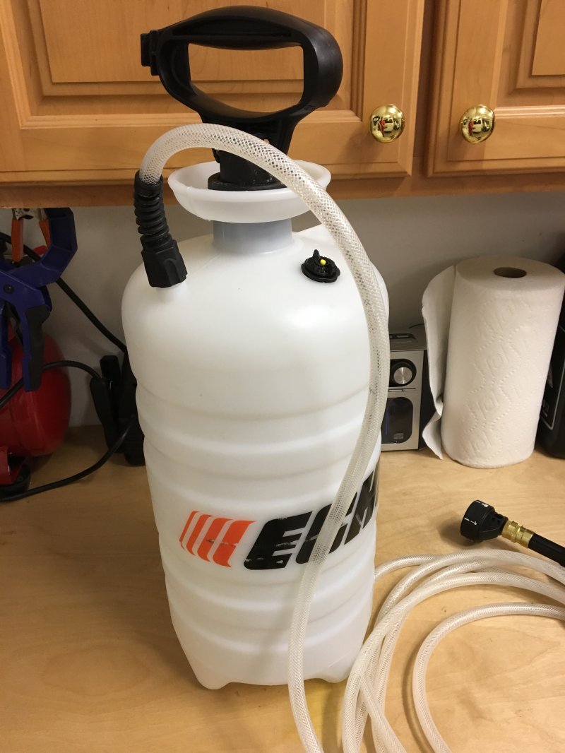

Gonna try this out tomorrow. I was able to alter this stock Home Depot pump sprayer pretty easily so that it received the Worx supply line. Maybe this is old news but I'm anxious to see how it worx.

Make sure you crack the tank some where, or just pump it up so worx dosnt create vacuum and stall

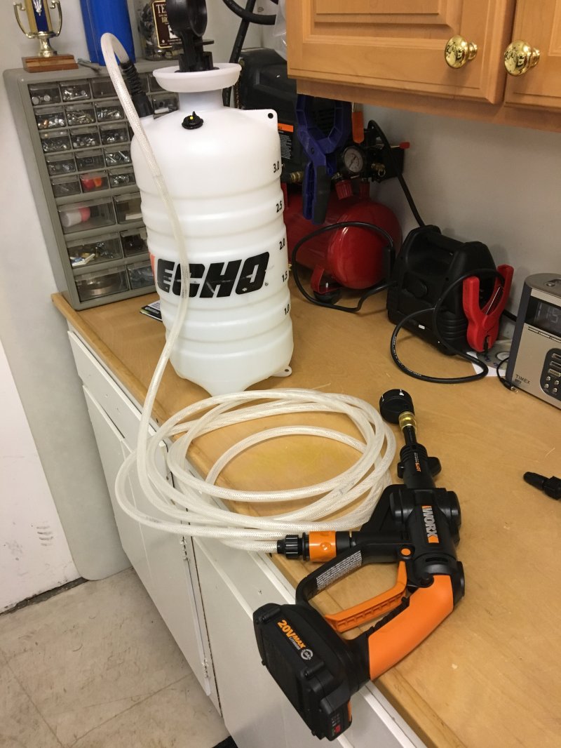

IMG_2026.JPG Shortened the hose and it primed quick. We did 3 large jobs today and there's 2 thirds left on the battery. I'm impressed so far.
