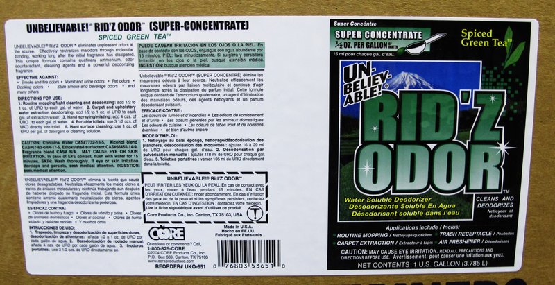

Ray gave me some of this to try..
At one ounce per it worked great, Not as nice a smell as Odorcide Spring Fresh, but it did exactly as we all hoped for. No urine odor at all (while we were there) at only one ounce per gallon. She was very very happy.

Uturn, Spring Fresh Odorcide and now this Green Tea..
All great stuff..
I let a barfed on sofa owner pick one of the 3 today
She picked the UT urn fit it's lack of parfumes

This unique formula contains quatinary ammonium, odor counteractant, cleaning agents, and a powerful deodorizing fragrance.
cleaning agents?
So, this is a product that needs to be rinsed? At an ounce or twoand 16$ per/gln... That's way cheaper then most products.
