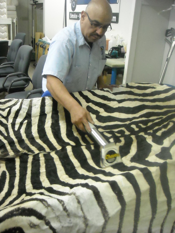

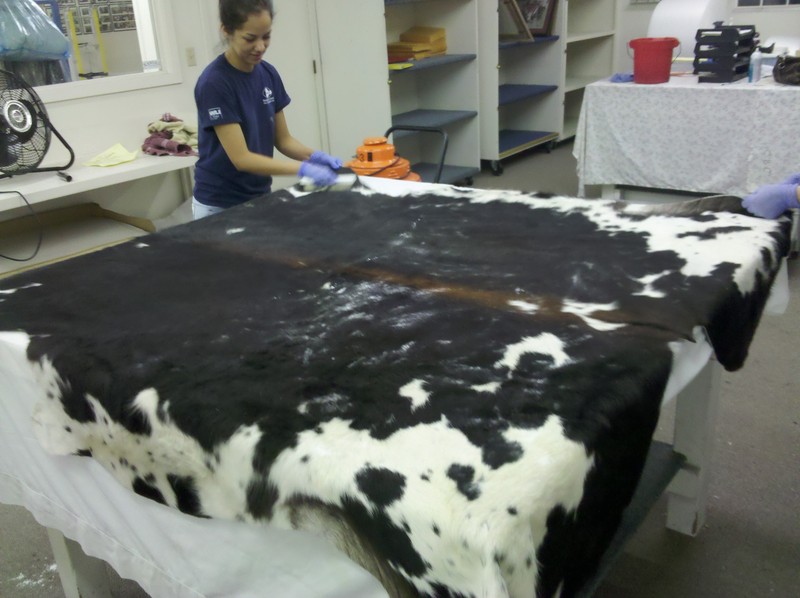

I would like to expect it before offering absolute advice on your piece. However, most of the time we do a full wash in our wash tub (or wash floor) and thereafter do some detail work if necessary with shampoos or detergents and thereafter centrifugal drying and hang. If a leather hide exists, then condition with leather specific conditioner afterward. (Cows and other animals take to water very well. How many times does it rain on them or they frolic in a watering hole or pond while alive? They don't shrink)

Are you saying the rug is Woven with cow hair-- OR is it pieced together cow hide? I have used the Sapphire tool on the hides with no problem-- you can adjust the suction at the head of the sapphire tool if you feel you need to. and yes clean it like any other protein fiber.
