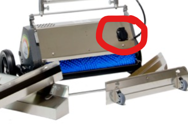

Aug 3, 2016
191
Eric
Reg Rogers
May 13, 2013
59
Reg Rogers
Looks like I might have the Pro45. Mine doesn't have this black box that is on the TM5.
Do the Pro45 and TM5 use different brushes? Mine are 18.5".
Yes they use different brushes. Sounds like a pro 45. Current pro 45s have the outlet on the back like the tms. Must be an older one.
That part # is G 39.
If that doesn’t solve it you have the option to send it to us and we can check it out for you. We service a lot of machines for folks all over the US.
