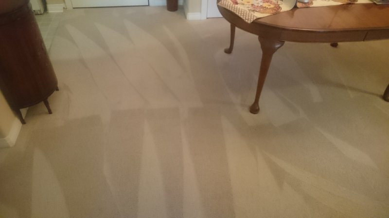

Two bedroom apartment. carpet is the infamous polyhorror crap. Crushed/matted down all throughout.

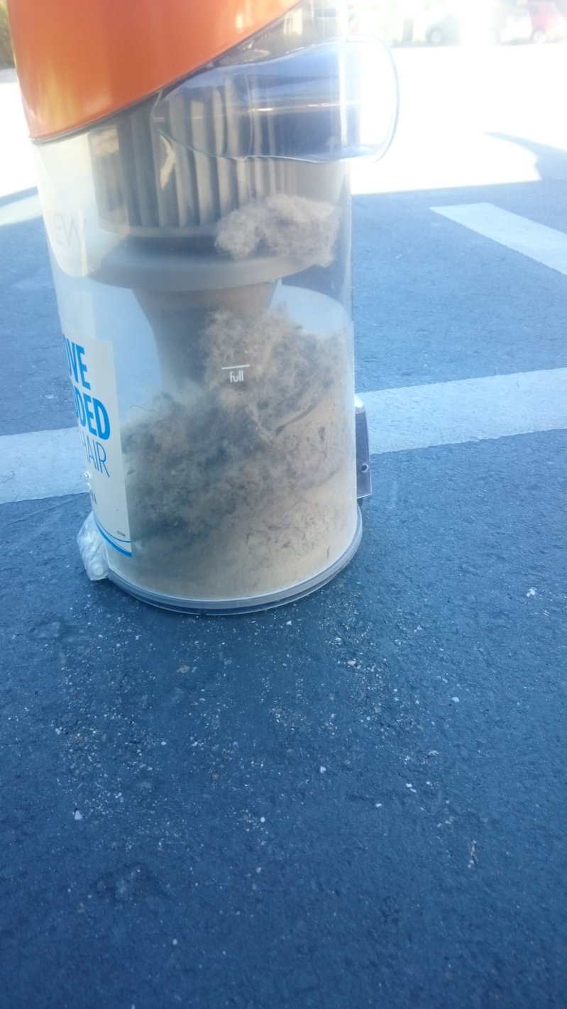

Vacuumed.

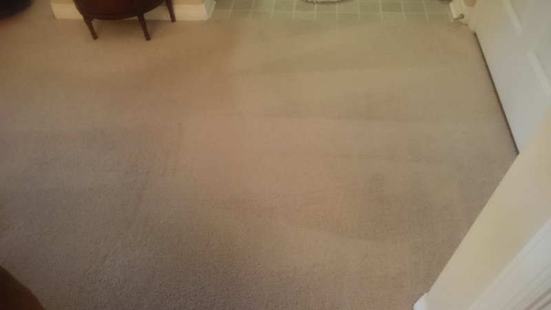

This is what it looks like.
Presprayed with secret sauce in the pump up sprayer.

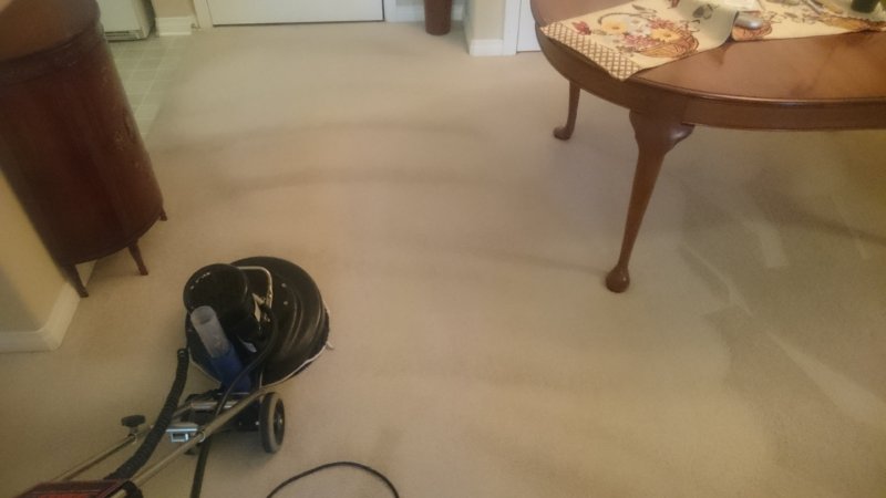

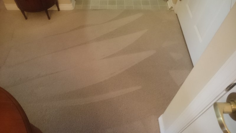

Got the much discussed CRB and scrubbed it:
This is what it looks like after CRB :
Looks good. We're done......

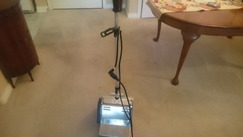

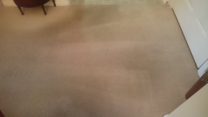

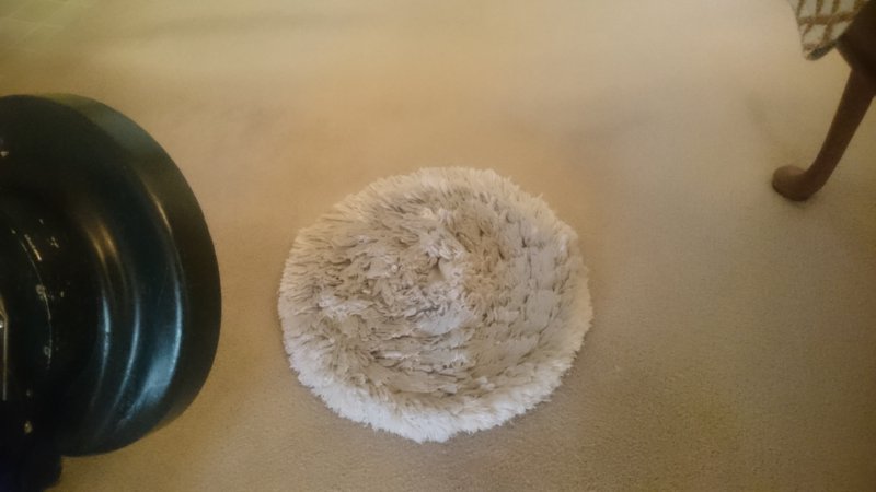

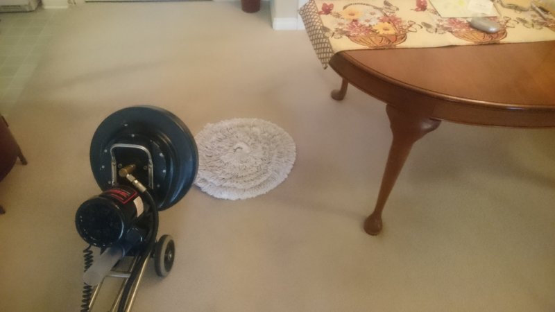

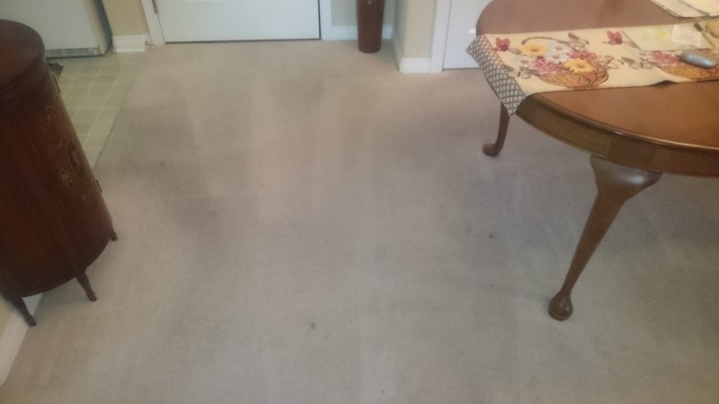

This is what I did next.

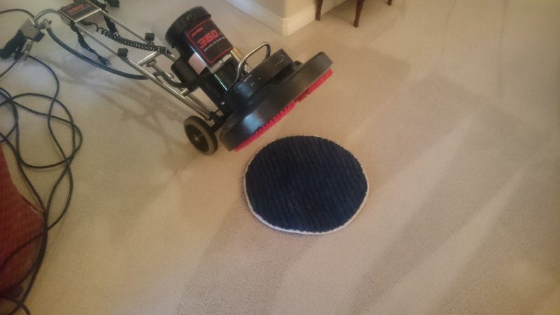

Got the 360XL with pad driver and the grey scrubbing microfiber pad.
Went over the area:

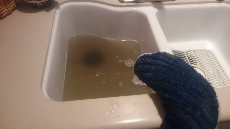

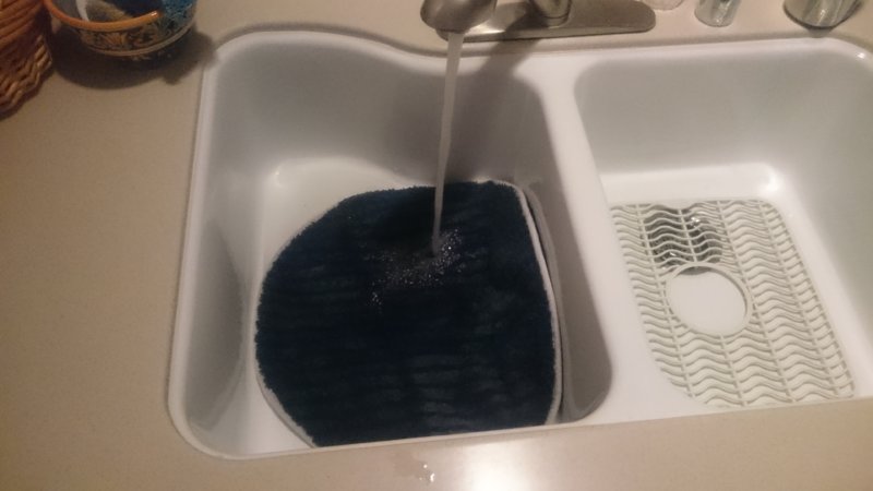

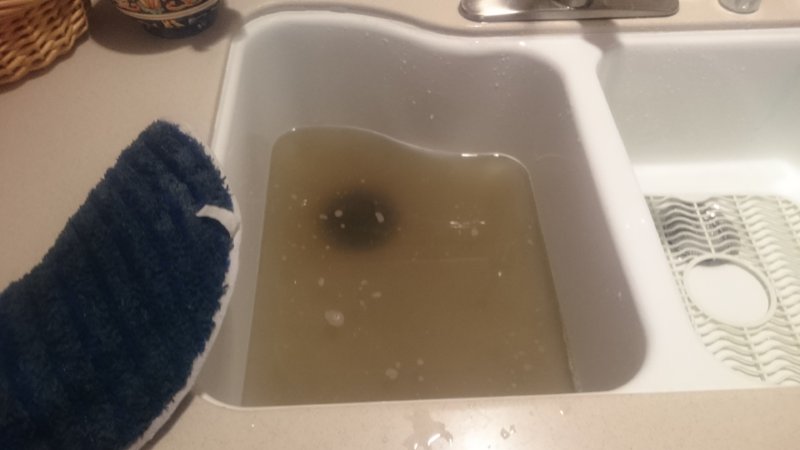

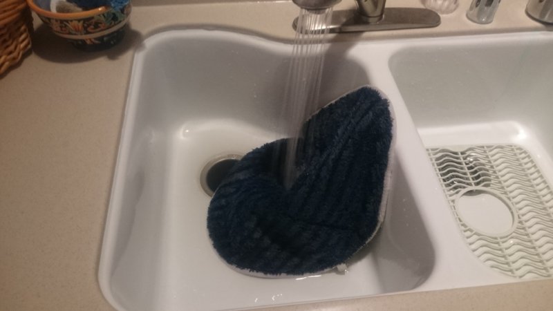

Next I did this to show some of you what you don't get. Rinsed the pad and hand wrung in the white sink. (to show the dirt)
Then I went over the same area with the pad and rinsed it again.
Round two of the rinse water:

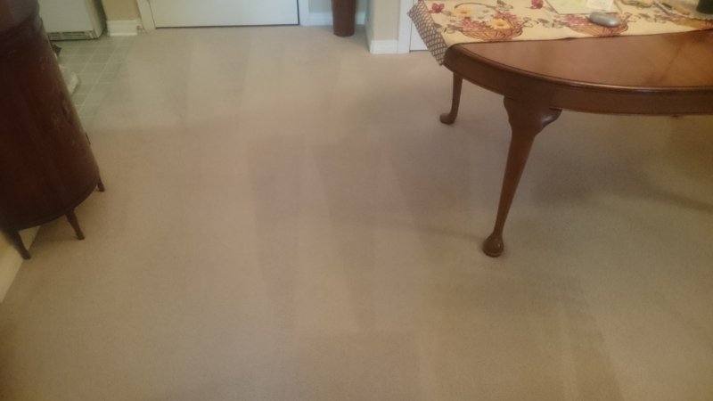

I grabbed a freshly washed but almost dry Chem dry pad to pick up even more dirt and moisture from the same dining/entry area.
I ended up using two handful of pads... This here is just that small dining area that I took pictures of.
I brushed it all out and was done.

I never had much luck with those loop style bonnets. Flat terry cloth types appear like they pick up so much more soil
Right...for picking up soil, I really like these micros with the scrubby lines.
http://www.directmopsales.com/MICROFIBERSCRUBCARPETBONNETS_s/108.htm
The white loopy ones are good to finish and dry with.
I have a variety of these white loops and they are pretty good.
http://www.directmopsales.com/CARPETBONNETSRAYONHIGHPROFILE_s/31.htm
And these
http://www.directmopsales.com/MICROFIBERCARPETBONNETSTRING_s/157.htm
Also have some Chem dry pads too.
Oct 10, 2006
3,740
Ann Arbor
Steve Lawrence
I can't keep those loop style bonnets under the oscillator. Much better luck with flat cotton pads. Wish I could get the stains out of the pads.
