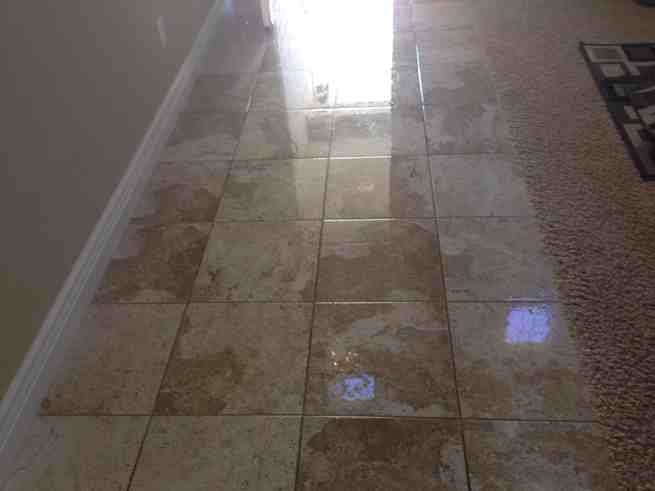

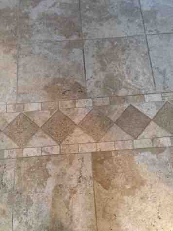

Another lovely nightmare customer form Roseville maybe I should quit servicing that area, I told her up front I can't guarantee that the color would be consistent without color seal. I even thought the grout was a lighter color, she cleans with vinegar and maybe something else that she's not admitting to. I could tell the inconsistencies in the color till after it fully dried. She wants all her money back from a 350 sqft job that she talked me down from from 350 to 300 after I threw in free grout sealer. She's made cause she said I should of tested the area and let it fully dry and she would said no to the job. She's color sealing herself and thinks she wasted money paying me to clean her tile in grout when she would've just put acid on the grout and color sealed without cleaning it, sound like a bad idea to clean the grout first, but cheap customers want everything for free. I cleaned the tile twice now, gave her $200 off my rate to begin with. If I don't give her the money back she'll dispute it with her credit card company, and may give me a bad review either way

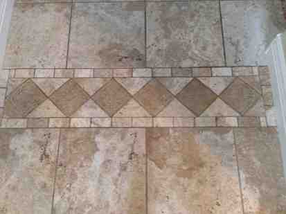

Grout after pretreating with powdered viper
I may have better after pic on another camera, I'll post them later

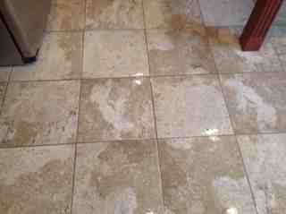

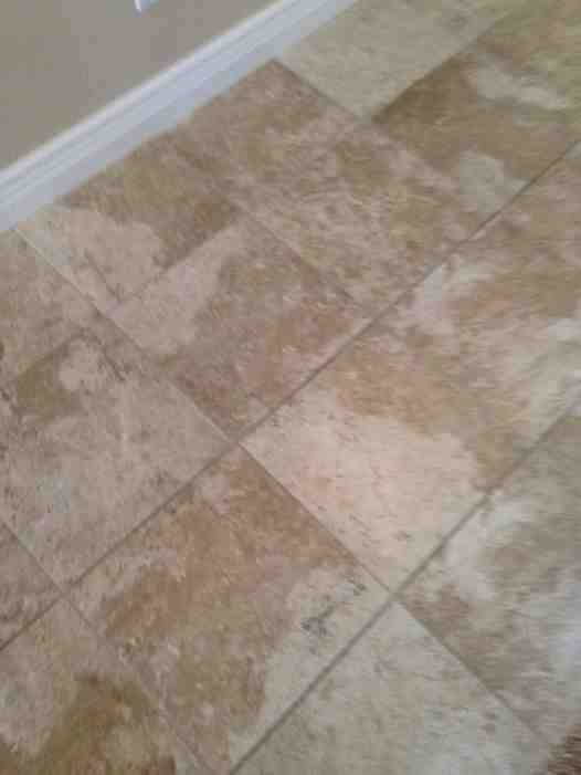

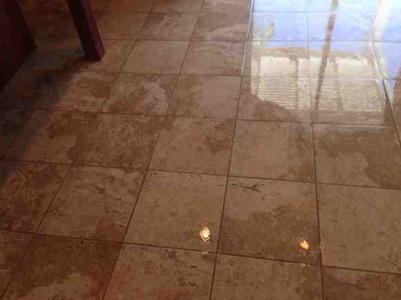

I've been in this business for 15 years, been cleaning grout for 8. I don't have as much work as I should have an have been too nice an discounted work lately since I get too many price shoppers. I've never seen so much discoloration in grout that is supposedly only 1 year old, I told her that I can't guarantee that the grout will be all the same color because of stains, discoloration etc. I didn't test a small area since she said it was only 1 year old. The grout is lighter closer to the base boards. I can't see how the grout stained brown in only a year and some grout takes longer to dry in some areas and couldn't tell that it was discolored until it fully dried. I speed dried with an Airpath fan. We pretreat grout with viper venom follow with prescrubed with a cimex with nylon brushes and hand scrubbing with a pole tile grout shark. Maybe she bleached her grout with who know what or mixed two different colors of grout by accident. I only guarantee color consistently if I color seal. She wanted miracles that only Jesus could perform. I feel that I can refund up to $100 and she wants me to eat the entire job.
