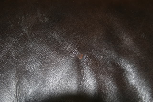

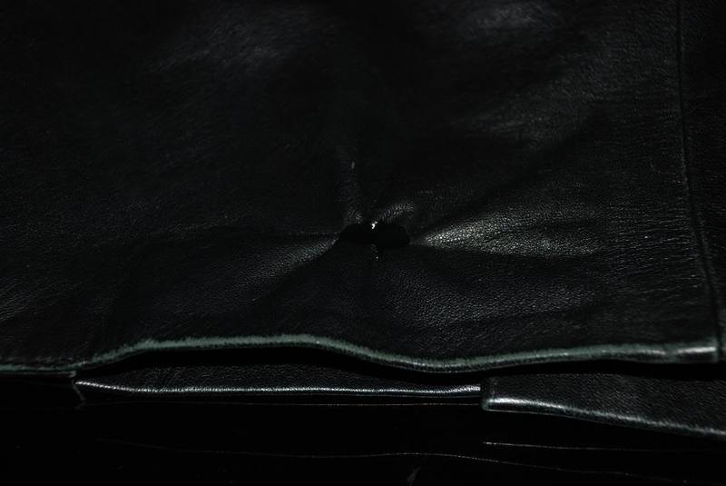

This suite was in a fire. The lounge room wasn't too badly affected, but the heat melted the lights above and a drop of plastic dripped on the ottoman leaving this tiny bit of damage.
It's a Chinese sourced suite and they only do fukll suites and no single units.
Finished two tone leather. The molten plastic has puckered the leather.
Can this be rectified?
What process would you use?
Cheers, John

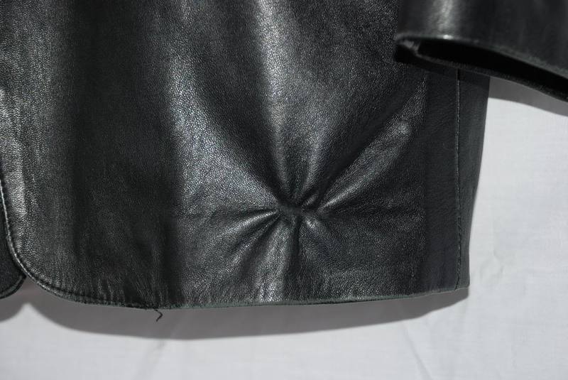

This picture #1 shows heat damaged that cause the leather to shrink.

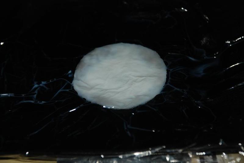

This picture #2 shows a pool of relaxer3.3™ that sits on the surface to rehydrate the leather.

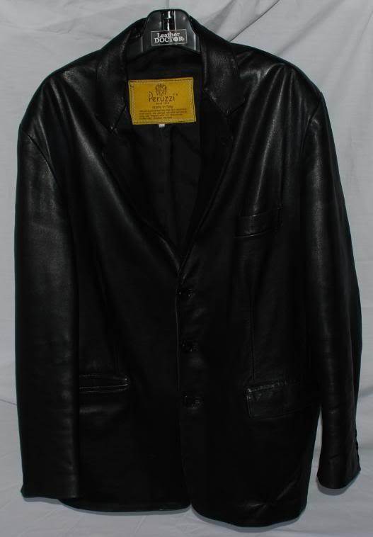

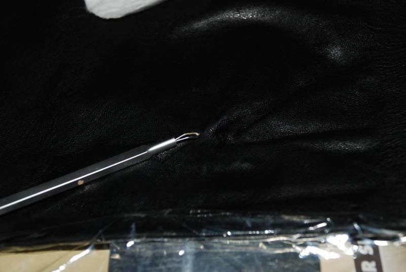

This picture #4 shows leatherTool6™ working to stretch the soften leather.

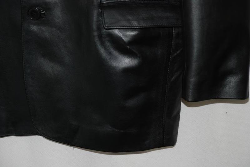

This picture #5 shows the result after relaxer3.3™ > fatliquor5.0™ > leatherTool6™ > d’Grease4.9™ > clean3.8™ > rinse3.0™ semiColor74™ > semiTop57M™ > leatherScent’B™ > Heat-Treatment.

The relaxer3.3™ that does the rehydrating takes an overnight soak, follows with fatliquor5.0™ an overnight soak too!
This two days soaking soften the leather to be work on with the leatherTool6™ to stretch the “cooked leather”.
Heat treatment (5-10 minutes) follows after the leather is completely dry after stretching (15-45 minutes).

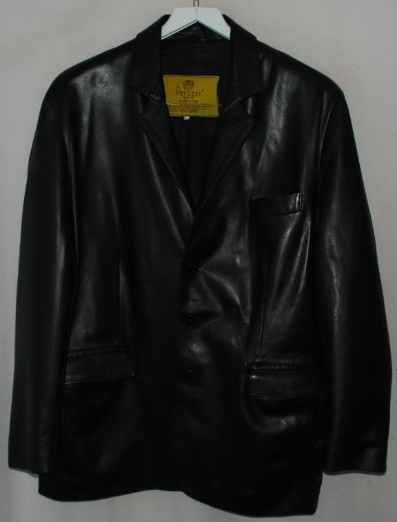

Picture #1 shows the before, see the crease on the sleeves.
Picture #2 shows the after, see the smartness of the sleeves (heat-treatment after fatliquoring).
