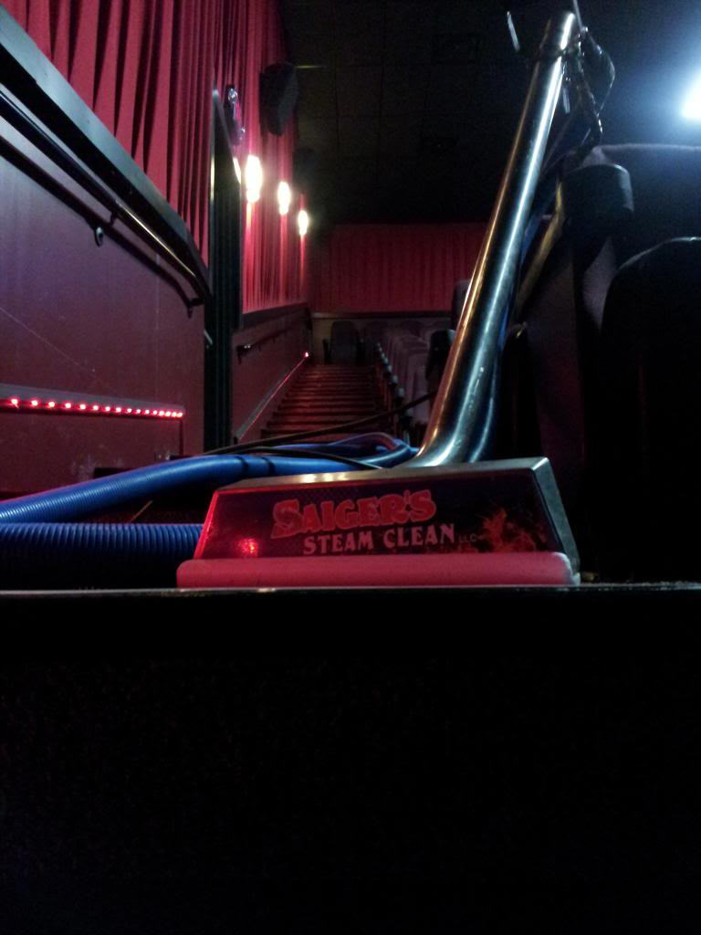

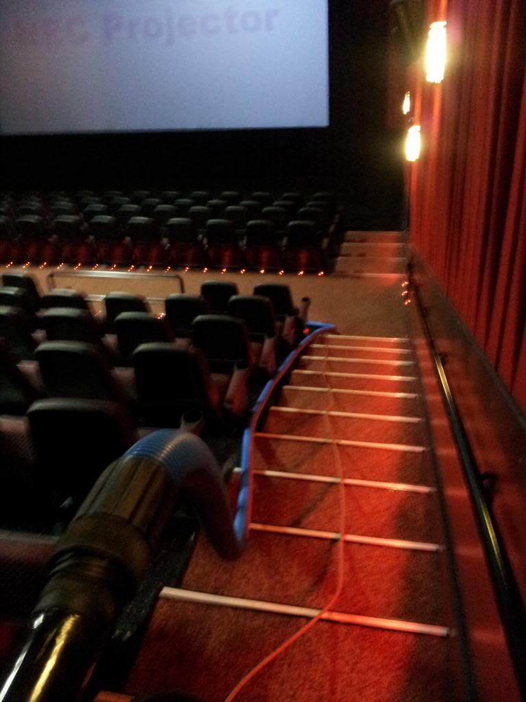

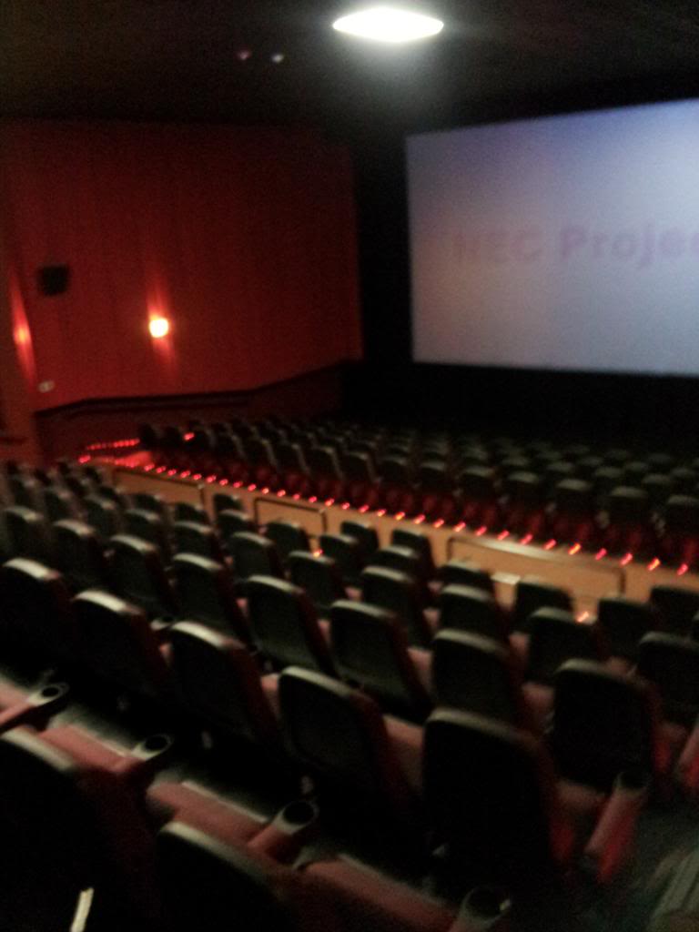

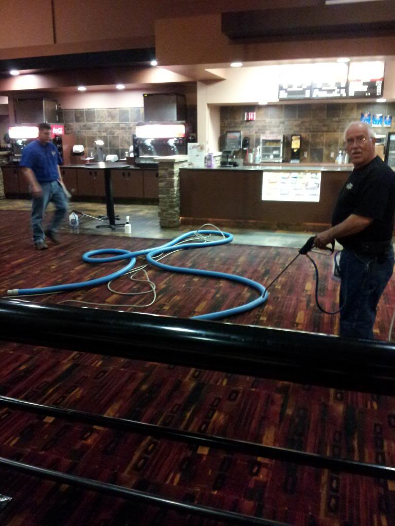

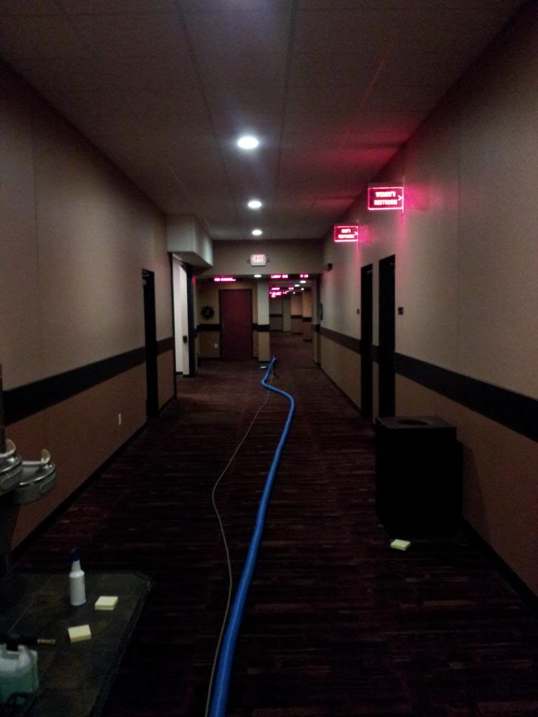

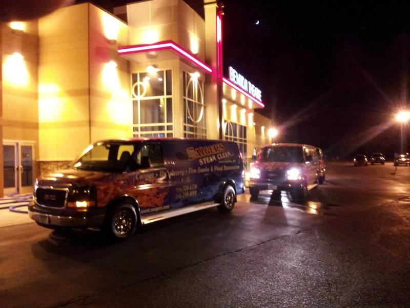

We have a movie theatre that we do with my Brother Dave. We get started at about 10 pm and get done around 1:30 am, then we still have a 1.5 hour drive home for me and my crew. We try to schedule off the next morning, but it never seems to work out. Always seems that we have jobs that next day that "just have to be done that day". Can't remember the square footage or the amount of steps....but a lot of steps!
We use my 2 Butler vans and my Brothers 2 Butler vans (which I just have happened to have owned in the past). No cimex....all Hotwater extraction.
