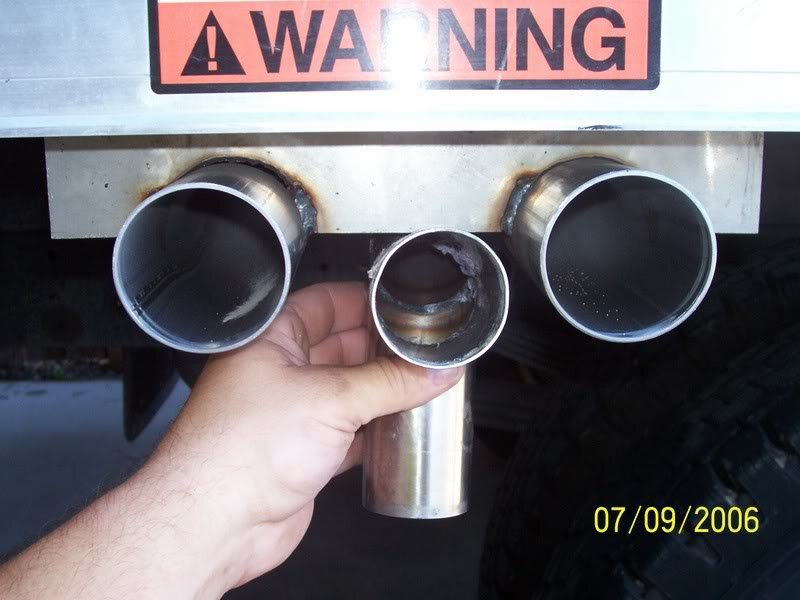

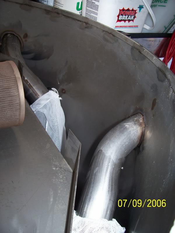

How did it go? More suck for the buck? Here are some pics of my 2.5 " change over.
I ran the filter sock for about 10 min.
What a size diff! I have other pics but can't find them. I think you will really like the 2.5"

It went real good. It took 10 hours but today I have to clean up the truck. Dust from welding and grinding, metal shavings from drilling. We ran the 2.5 steel through the metal piece at the bottom of the box so we could run stainless steel straight without cutting into the box frame. It looks pretty cool.
I have pictures. I will get them after the truck is cleaned up. I may have to email them to someone or find out how to get them here.
