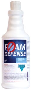

Most every defoamer, whether liquid or powder, should not be mixed with cleaning chemicals prior to emulsification. While they do not cause problems after emulsification, they will impede performance prior to established micelle formation. Powdered defoamers used on carpet surfaces are used after presprays have been applied an agitated(post emulsification).
Notice I said "most every defoamer". Bridgepoint does have a defoamer additive, called "FOAM DEFENSE", which is alright to be added to presprays. I don't know of any others off hand that are also suited for prespray addition.
