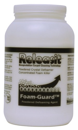

Liquid defoamers aren't terribly effective. In many cases they don't work at all.
On the other hand, a good powdered defoamer will completely kill the foam.
As mentioned above, Chemspec's Crystal Defoamer is very good.
Releasit Foam-Guard works great too!
http://www.excellent-supply.com/Rel...l-Defoamer-8-pound-jar-4-to-a-case_p_282.html

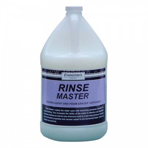

I always carry Chemeisters Rinse Master for those rare times that I encounter foam issues. Mostly it is from a customer applied detergent on an area, and sometimes it is a concentrated spill of laundry detergent, in either case it will not rinse out with my FWR. So I apply a mixed solution to the area with a trigger, or if it is a spill of concentrated soap, I just pour the Rinse Master straight onto the area. It rinses right out. It is the only defomer I know of that is actually meant to be a rinse agent metered through your chemical draw and used as a final rinse. Great inexpensive (21/gal) product to always have on hand.

I've used Rinse Master. After a while with all the stuff being added to the metered container I wonder if any of the chemicals are offsetting each other.
Here's what I've been putting into my container:
Flex Ice
Fragrance (Chemeisters or Judson)
Rinse Master
EncapuGuard Green​
Any criticisms?
