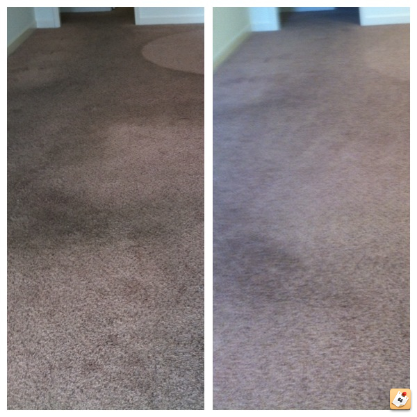

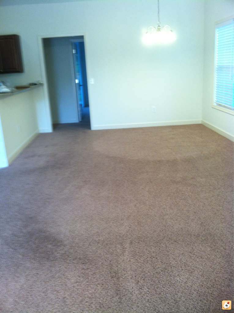

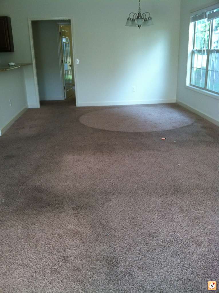

Ever have one that no matter what cocktail you throw at it, just won't cooperate.
2br Townhouse, Frize Carpet (sucks)
Any heel grinding on this stuff and the light never reflects correctly again, traffic wear is horrid.
O2 HOT and Rinsed beyond well : )
Rotovac'd the dog snot out of it with the mixes pegged on high. 4 jet head
Going to celebrate my first big defeat. Right after I invoice it for a min. : )
Installers are going to have at it in the a.m. We were all on the same page and prepared for the worst.
Arrrrggghhhh : (

10 to 12 oz of Judson slop and gobble. 1/2 cup of ammonia (clear) in a hf scrub with a red pad dwell for 15 mins and extract

What was the cause? Newly sealed Driveway? Or Quicky Lube? Porno Film Set? Last CLeaned? Or is this a ......?
114,150
sort of hard to tell from your crappy photos but it looks like garbage carpet to begin with
You'll learn when to bow out sooner than later
Don't slit your wrist just yet.

and use something besides 02...it's crap
if you're a Judson lover, get Slop 'n Gobble ...it'll kick 02's azz.
Be sure to mix it stronger than the ridiculously low thimble full per 55gal drum he suggests
2oz S&G pr gal mixed it hot water and it will rock

I used S&G Hot on the darker spots and it did lighten it slightly, even after the O2 modified. Dwell times were good, cranked the pressure up to 500.
To be honest I believe it is caused by a mixture of barefootedness, combined with burning incense sticks, topped with powdered deodorizer. And a blacktop parking lot.
There were 2 adults, 1 child and a lil fuzzy white dog.
We have had alot of problems with this style carpeting in these particular units. They have 1 unit of it in the big complex across town aswell.
Being Apts. I am sure it is not the best floor covering on the market either, but still arrrggh!
We had one that had some traffic areas like that, not as bad over all but concentrated paths. Cleaned just as you did and it cleaned ok and looked but but it was until we put a powerhead on it that it came clean. I think you need more agitation, either with a 175 or a powerhead. If you see a lot of them like this I'd get a powerhead, you'll out clean anyone using only a wand. I'd also try something hotter as suggested, S&G, Flex, or John's Prochem mix something with a bigger bite to it.

Why you need the right product for the job. Trying to use an enzyme on asphalt is never going to work. Wrong product. You need a petroleum digester not an animal fat digester. You can't fix everything with a hammer no matter what hillbilly tells you that you can.:) Not that I calling anyone a hillbilly just sounded funny to me after not sleeping all night because of my neck :(
31,116
Thanks for all the input guys : ) and Thanks John
are you mixing it at Les' fairy tail dilution ratios?
you have to triple them at minimum to handle a rag like that
get some great chems on your truck
Prochem Ultrapac and Powerburst....two of greatest in the history of the world
and I wouldn't be a bit surprised if the new Prochem powder Olsen is hawking is a winner too
Prochem has the best chem line overall ..
Having said that, not "every" chem they make in the greatest.(their olefin pre-spray ain't chit)
Ultrapac (#711) kicks it's azz...and I ain't a fan of their All Fiber Resigoo either...but as a chem line "overall", Prochem is the best.
anyone that says different, don't know sheeit...and you can tell 'em I said so :biggrin:
