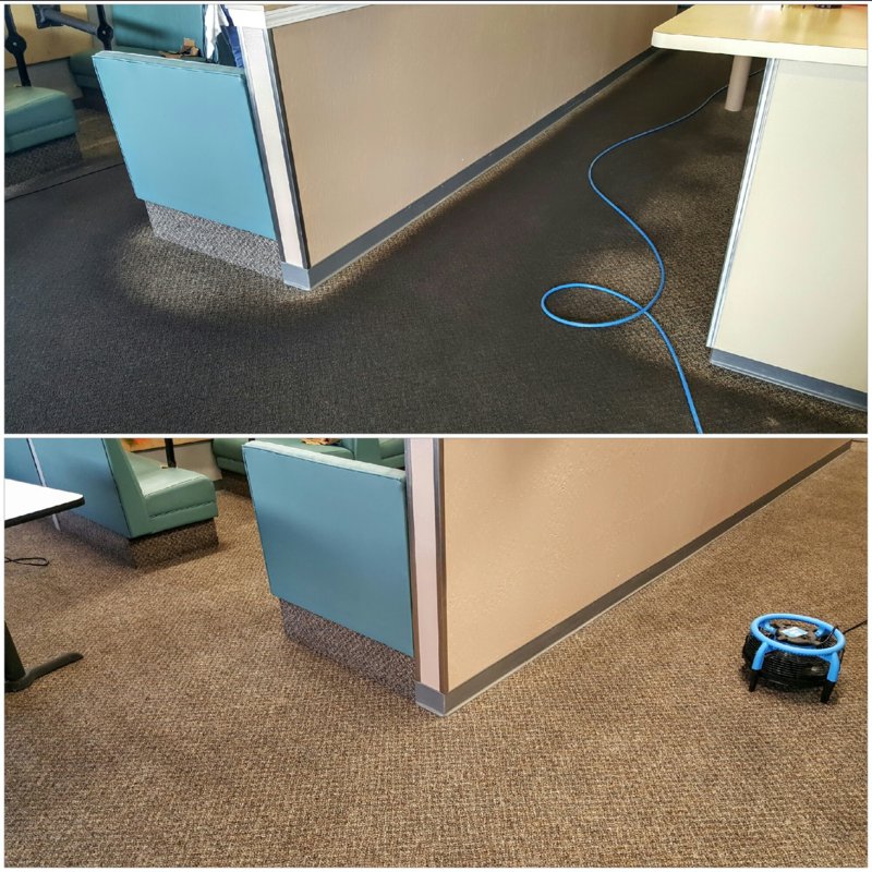

I once cleaned a 300sqft Chinese place that the only way you could tell it was carpet was to move a booth. It was black, and had the texture of asphalt. This was back when I was hacking it for my boss, and was using a wang enterprises Banshee with a diesel burner. Used a 175 with red pad to put down tide and orange-sol (dilemonine) then extracted with an aw-29( hackity mc hacking!

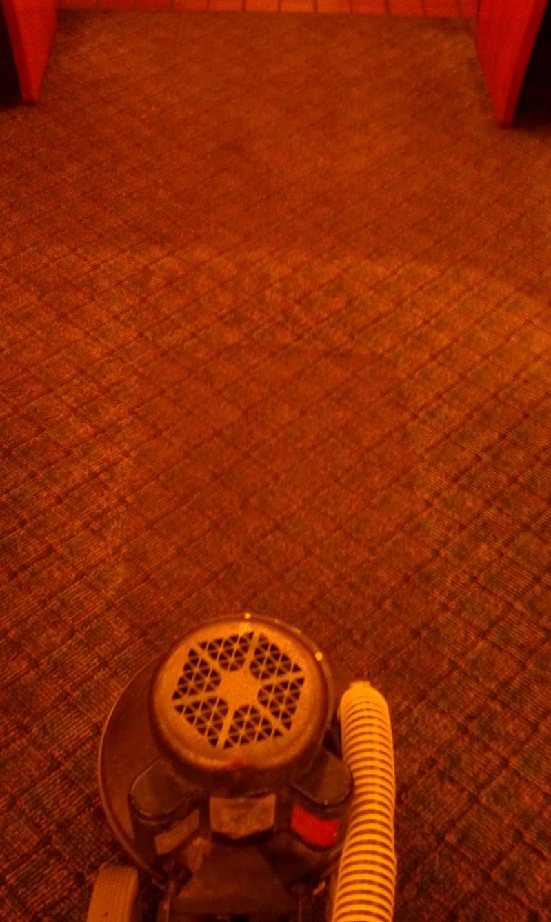

This isn't some nasty hole of a place just a normal photo of what we do on a regular basis with our contract work.
I honestly don't know where some of you dine to get that stuff. LOL

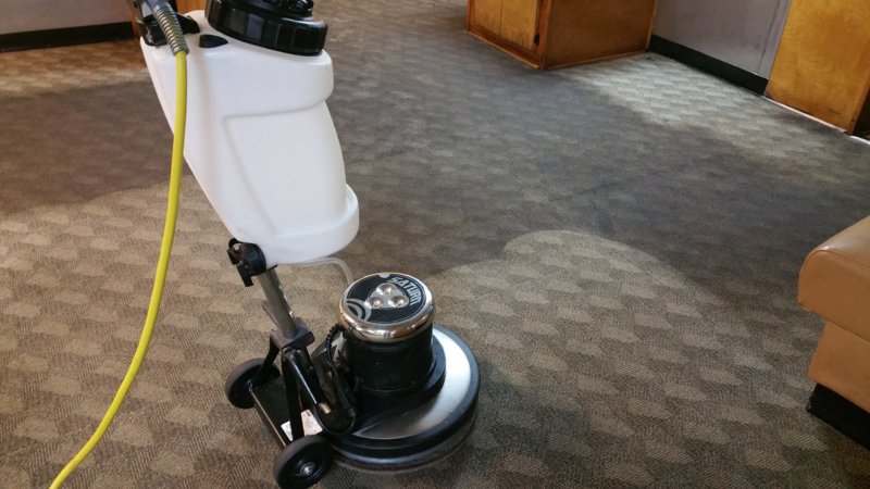

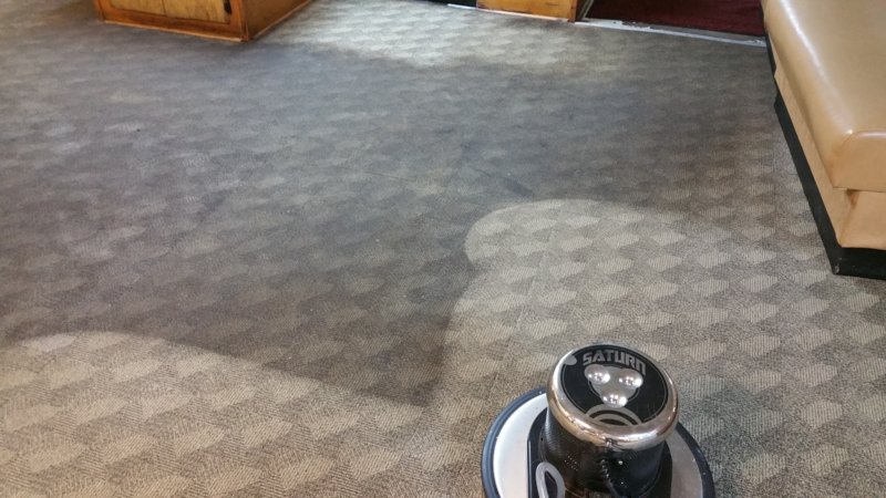

Nice
You just absorbent pad-capping with a showerfed 175?
Pre-spraying?
What type pads and juice?
Thanks, I used a dual speed rotary at 300 rpm's , scrubbed with a burnishing pad and presprayed with chemspec foprmula 90 at 2 scoops per gal with added harvard powdered citra solv 1 scoop per 2 gal, I normally use procyon extreme but was out.
I could have followed with an absorbent pad and that would have been fine but they were expecting hwe so I followed the scrub with a steamin demon.
I do other restaurants that I just scrub and pad, but I only do a few restaurants.
