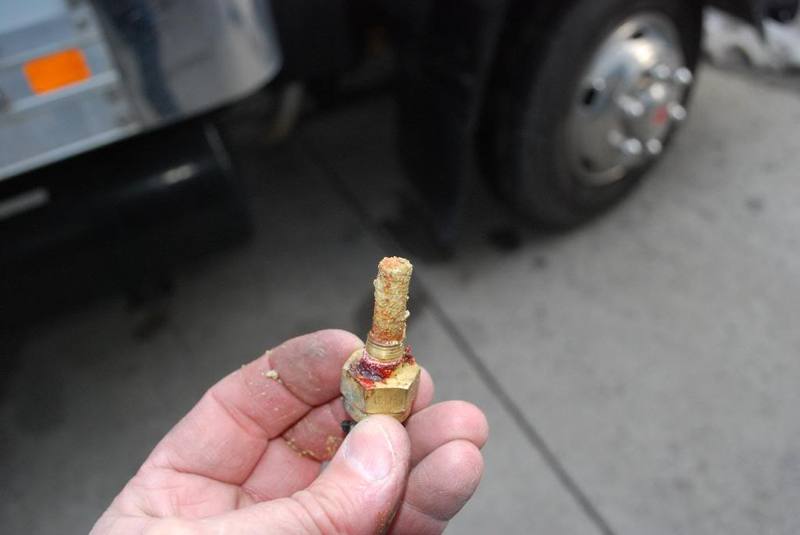

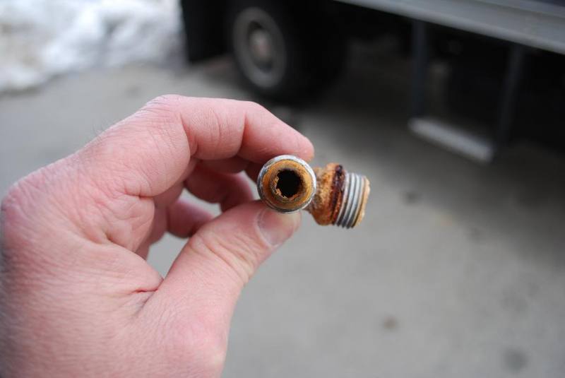

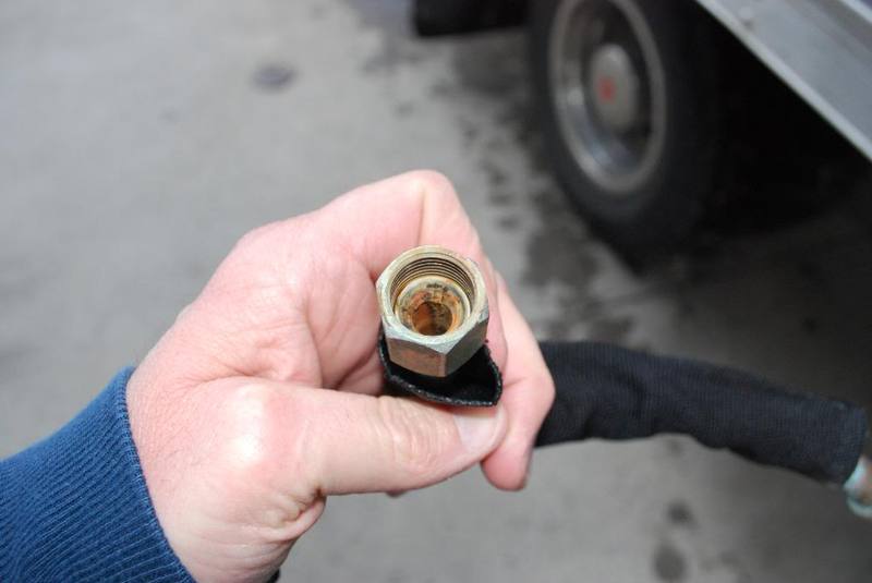

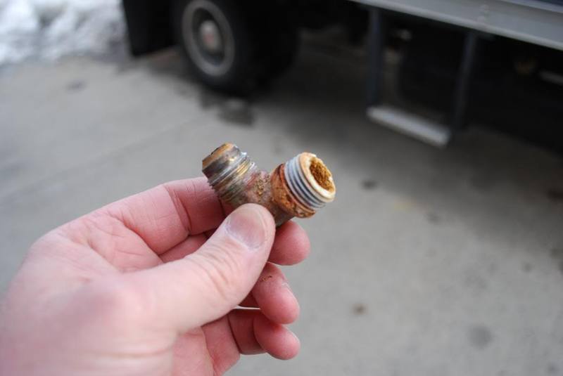

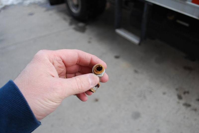

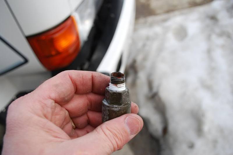

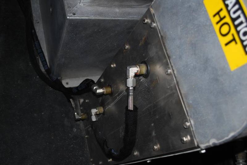

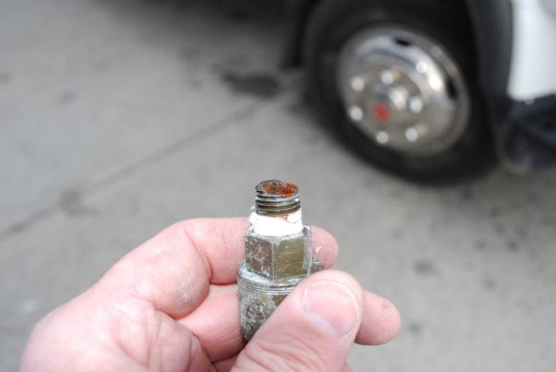

The use of different metals on the Vortex units has been expensive and time consuming. They were built with copper heat exchangers, brass jic fittings, s/s sleeves in the female jic fittings. The pickup for the Speedhut pressure gauges is steel. The sensor for the Speedhut temp. gauge is brass inserted in the s/s heat exchange, once it corrodes it stops working (2 months). I would like to see as much s/s as possible on any new premium truckmounts.

Honestly this is one reason why all the talk about non proprietary parts sounds good but actually works against people over time. In many cases it results in fittings that are designed for residental plumbing (and may barely pass a spec) being used in industrial applications causing problems. The exhaust diverter valve is especially an issue today with increased exhaust temps of 1400 degrees resulting in dissimilar metals expanding and cooling at different rates creating issues. The question was asked of the truckmount forum as to why more stainless wasn't used. Mike Roden noted that choosing the proper metal is critical and commonly overlooked.
