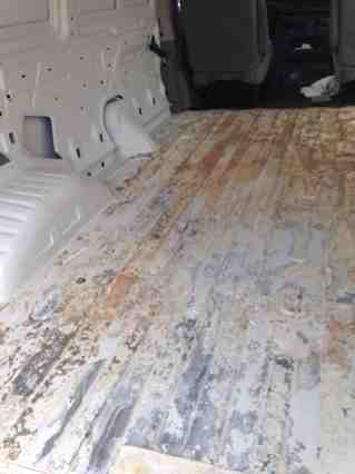

I used Herculiner on my van. 3 coats and it turned out great! First I sanded the sh#t out of it with a wire brush to break loose old paint, rust, and dirt. Then I pressure washed it do more of the same. Then I used the little sander pad thing with the Herculiner kit to break free more stuff. At this point I worried I may go all the way through the floor! Then I rubbed it in muratic acid. Then finally 3 coats!
The last Herculiner I did has lasted 7 years, so I'm hoping for the same!

Well, it took probably about 3 hours to do all the prep work. The first coat probably took an hour to apply. Coats 2 and 3 were quicker. It took the better part of yesterday, but I didn't rush through it. The temp was a cool 110 here yesterday, so I mixed in a couple jumps into the pool and a few cold beverages.

By this AM it felt completely dry. It dried fast yesterday too. It is beyond hot though, here. I set my debit card on the drivers seat and left it for about 15 minutes yesterday, came back and it was like soft rubber, it literally melted. Never have seen that.
I won't be on it for a few days. It's in today getting 2 new tires. Install is set to begin next Monday, so I have a week to do anything else I need.
