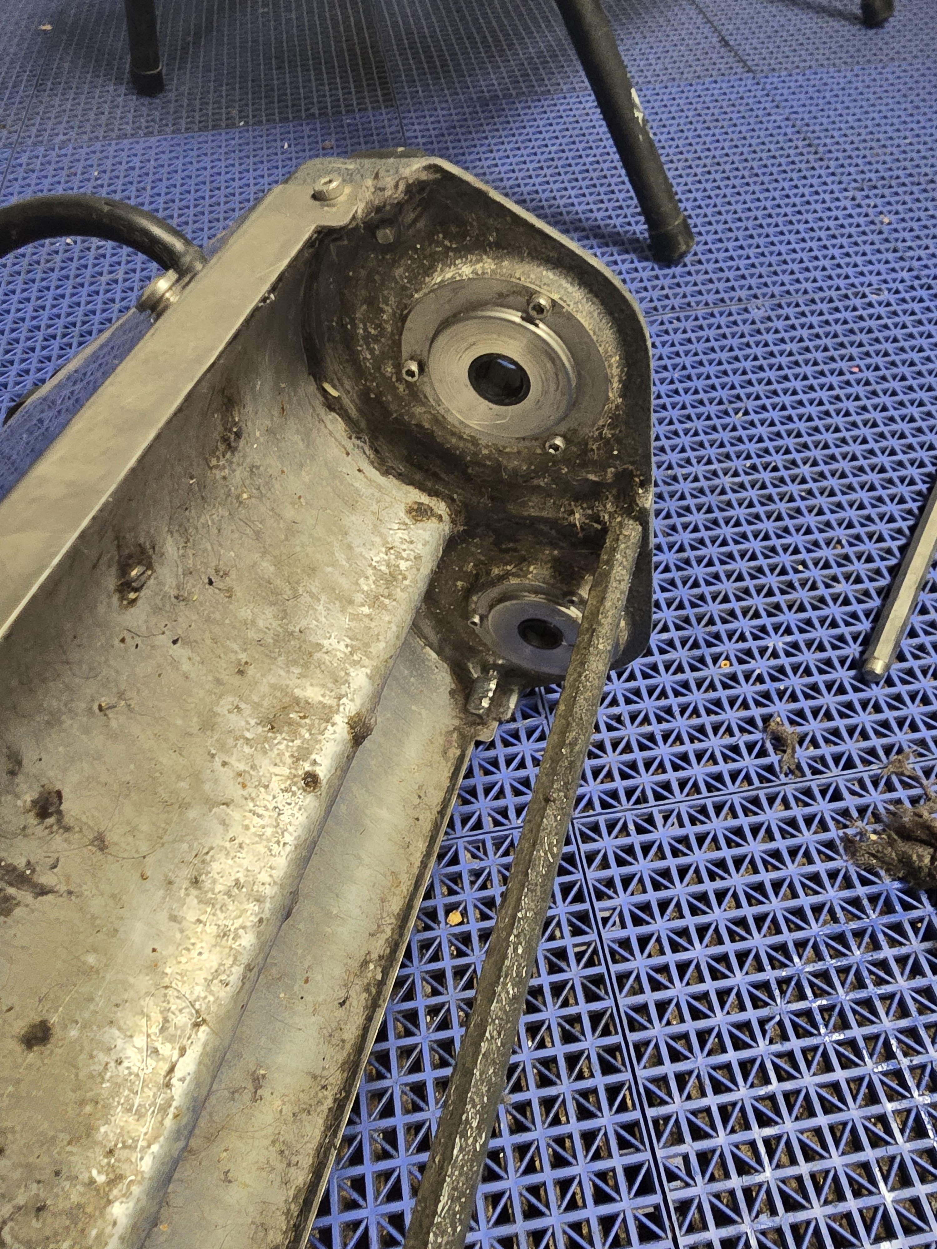

Because long hair and staple fibers build up to the point where they blow out the seal on the bearings from too much pressure. The cover should be removed as needed depending on use it but if somebody's using it on every job I'd recommend quarterly
The question was do they need to be "removed and lubed"...
116,849
Removed and cleaned under the cover
