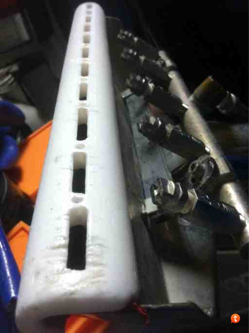

Does anybody here tweak their green glide?
I use a slotted glide.Lately I've widened the slots and also made the groove deeper. I use PC Ti.
No scientific tests but it seems to do a better cleaning job and slightly better water recovery. It glides about as easy.
Anybody else tweaks their glide?

I've never had the resources to test this, but here's my thinking:
  • Wand opening too wide = lockdown
  • Wand opening too narrow = low CFM, poor recovery
The best operating point is somewhere in between. What's the optimum setting? It depends on many things. How wide is the wand? Blower CFM? Hose length/setup, etc.
So, I could see where the best setting could vary from person to person. The glides out there have to be a middle-of-the-road opening, but that's like saying the average family has 1.4 kids - not really right for most.
I could certainly imagine there might be gains to be made by tweaking the glides, but depending on the individual setup, better could just as well be smaller as bigger.
I would think, for instance, that portys could use a much larger effective opening than a TM.
I know, too much time on my hands....

That is why we offer all three configurations, so you can choose which is best for your machine, types of jobs and level of hackishness.... Generally the slots are as wide as they can be and not be wider than the original slot on the wand. The only folks who may get better performance by opening up the slots are those with VERY big blowers; #6 and larger. otherwise you will get more "bite" (it will be harder to push) but that won't be an indicator of more water recovery. The only thing you might get is more debris removal. if you open the slot wider than the slot of the wand, you will draw in larger debris that can't go through and the glide will clog much more.
Note for those modifying glides: You can make a hybrid out of a hole by joining holes together, but don't do it too much or your glide will lose it's integrity. You can't make a slot out of a hole or hybrid without messing it all up. If you have a hole or hybrid and want a slot instead, contact us and we will exchange it for you.

Sorry Lisa, but mine works better after the tweak. I like it.

Send me a pic of just what you are doing to it. Also the size of your powerplant....and I know you men like to exaggerate on the size of your powerplant....

But it is pretty simple: I just widened the slots a little (nothing dramatic) and deepened the groove (as it tends to flatten and it does loose its roundness eventually.)
The difference is not super dramatic and was not measured scientifically. But it seems to be somewhat improved. Or at least it made me feel better about myself.
My dependable, yet moderate :icon_redface:, power plant is a CDS.

This thing was all hole and it irritated me so much I kept kicking it off an throwin it back it the truck. So i sent it off to be hacked on. Much Much Better.
