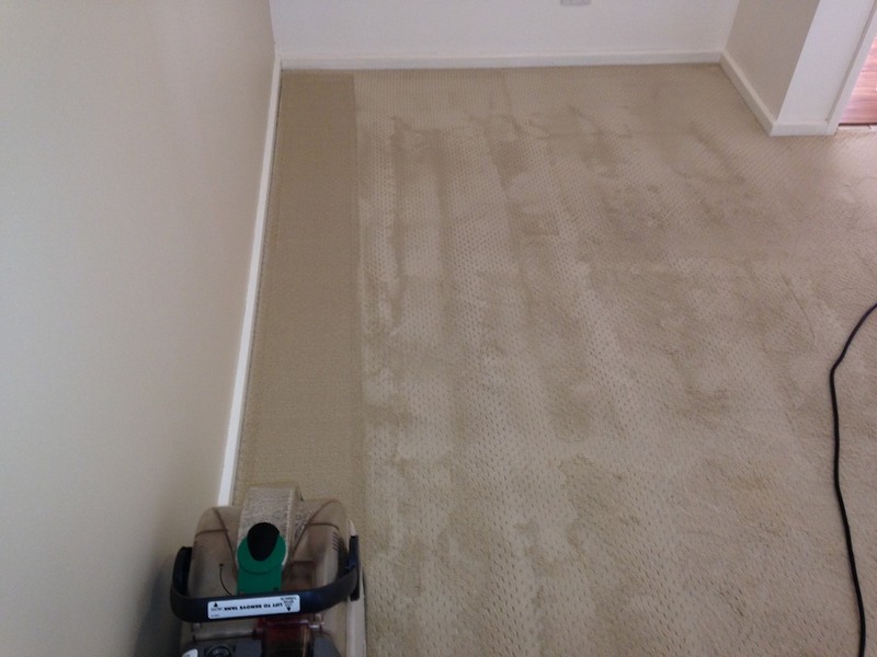

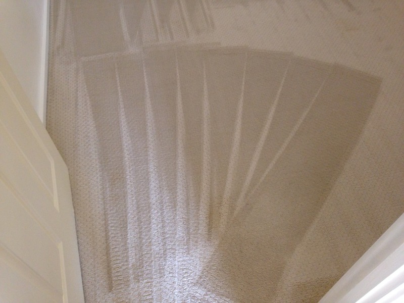

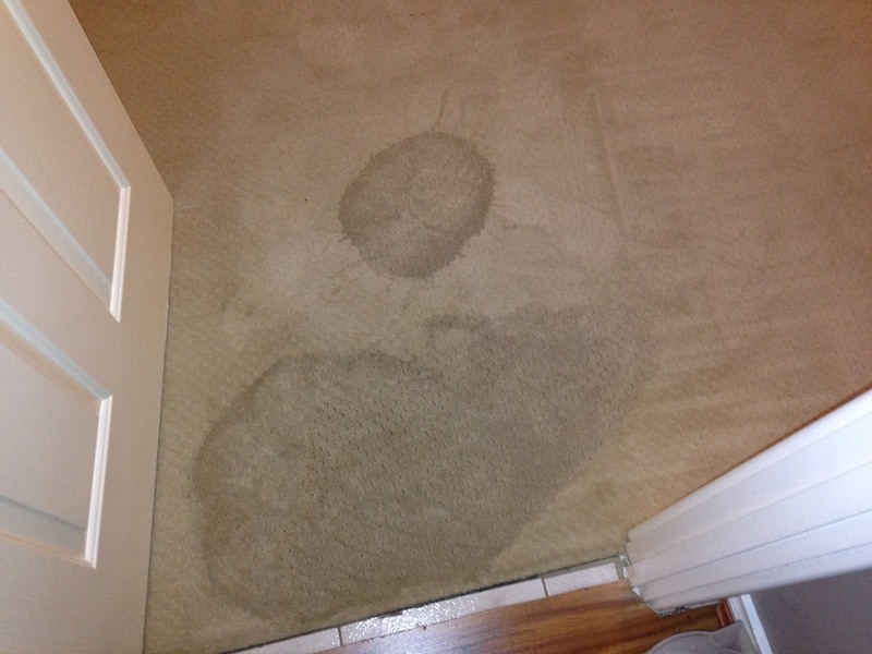

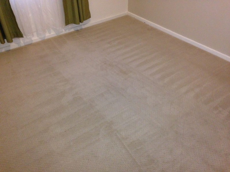

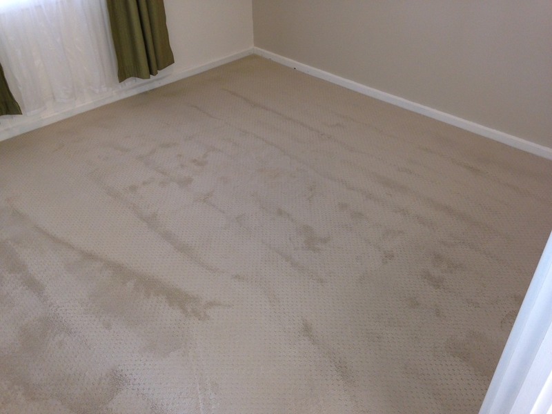

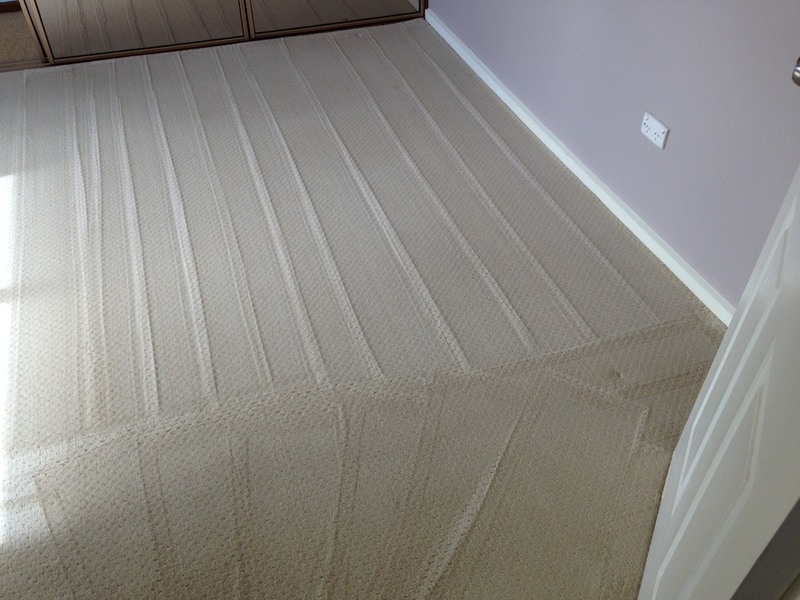

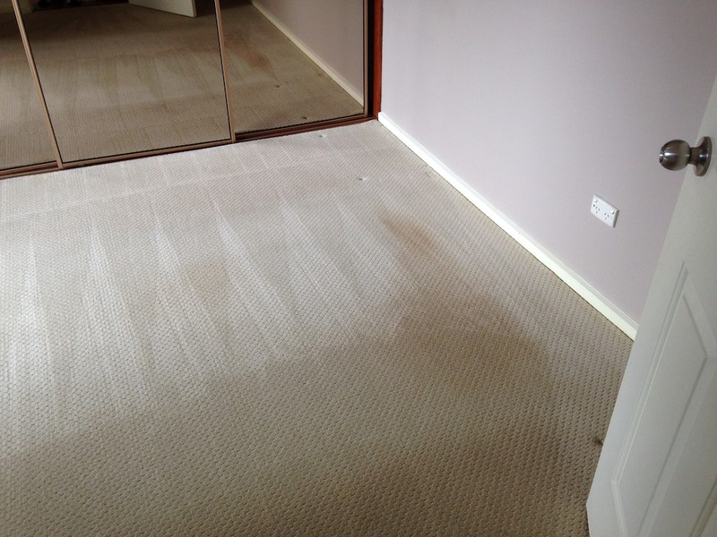

Thanks to everybody for the suggestions. I did the job today. It came out OK. I can still see shadowing now I have come home and loaded the pictures into my computer. The customer was happy and I think I have secured ongoing patronage.
I used Scot's Tuff PowerMax LVC with OxyShot!, CitrusBoost and some CleanScent to fight the dog odour. In retrospect the PowerMax is a little bit anaemic for this kind of soiling. I will go in search of a hotter PH encap I can HWE rinse.
Before (Vacuumed Only)
Mid Cleaning ( Just Pre-Conditioned)
After Extraction

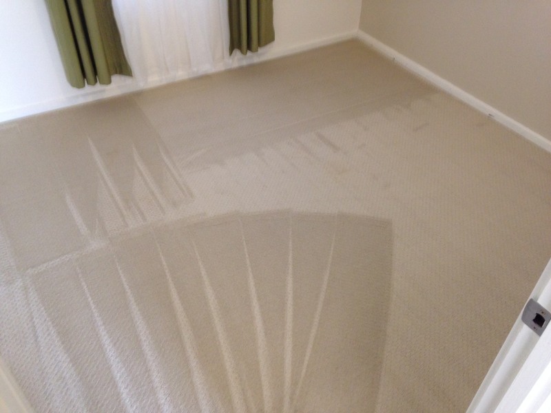

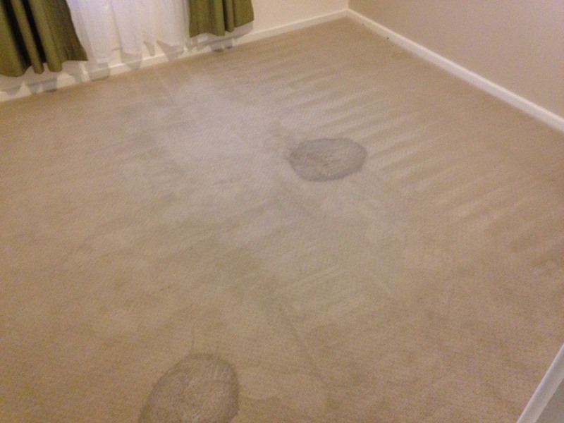

Small Bedroom - Before (Vacuumed Only)
Pee Irrigation (OxyShot! & CleanScent with Hot Water - 90 Minute Dwell)
Mid Cleaning (After Pre-Conditioning)
After Extraction
