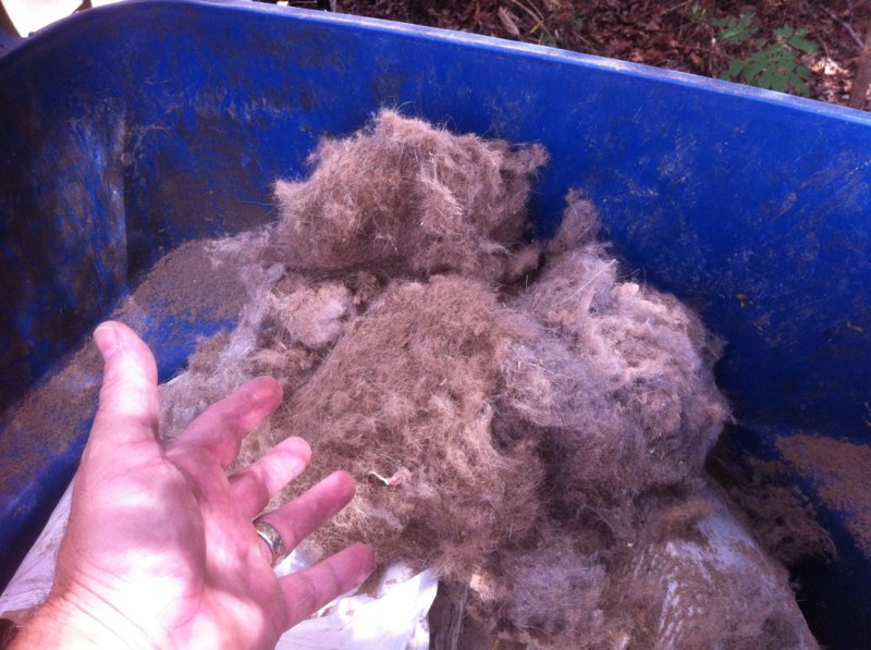

See this? The brown lump is my pre-vac (after the owner had vacuumed). It is about the size of a gallon jug. The grey lump is my post-vac after encapping with DS2. It demonstrates that the remaining hair and soil is slick enough after encapping to release when vacuumed. In other words, the vacuuming is an important part of the process.
That carpet was cleaned before I had the CRB and I scrubbed it with a 175/red pad combo. Then I bonneted the surface. Guys, it came out beautifully. It doesn't magically "hide the soil" it makes it easy to vacuum up.

You just didn't get it all the first time. :stir:
San Francisco, CA
Looking closely at the picture and due to my superior power of observation, I can tell you with certainty-It worked!

Yup, that is pretty much the point, haha!
As for too many steps and a truckmount is faster, that may sometimes be true. However, I cannot afford a dedicated van for a truckmount and often, my customers have had bad experiences with the Big Hose company. They seem to like the idea of the door being securely closed, too.
I guess it boils down to getting it done.
