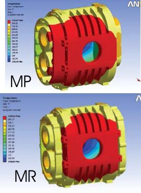

Roots has had Dual Splash for several years.
I think they were the first of the "big two" manufacturers to have it available.
Now, Sutorbilt has the "MR" series with the gearbox separated from the airflow chamber.
It keeps the heat (Red below) in the HX, while cooling the gearbox for longer life.
http://www.gardnerdenverproducts.com/assets/0/180/140/186/ed0c4a0f-a529-42dc-b632-7af2c98f1d33.pdf
